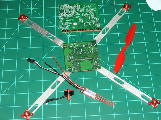

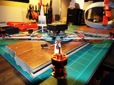

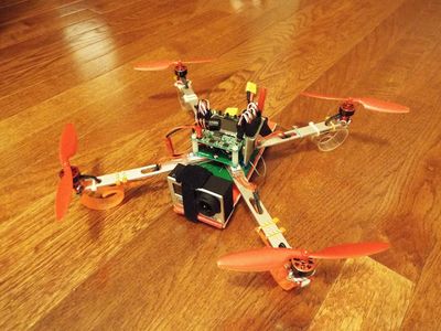

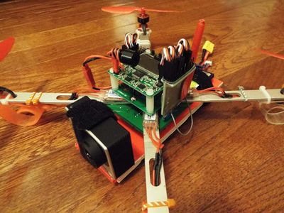

A few years ago I purchased a mini quad copter for myself as a christmas gift. I learned to fly this mini quad copter and that inspired me enough to build a DIY quad copter. I decided to learn more about these micro electronic so this is what I created. For a more stable frame I used four aluminum arms from an old computer hard drive storage array. (dimensions - 13in x .5in x or 330.2mm x 12.7mm) For the mounting base I harvested an old 10/100 baseT network card and removed all the ic chips, resistors, and soldered parts that were on the board. I cut it in half and super glued the arms to the board. As shown in the image above.

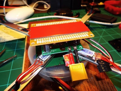

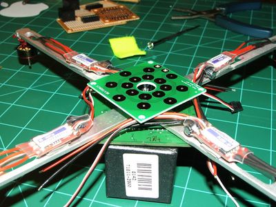

During the initial build I tried a few different configurations, but found the best setup below. The electronic speed controllers and network card are attached to the arms with 3M double sided tape from Lowe's. I used a combination of super glue and 3M tape to connect the multi-rotor distribution board. I brought the signal wires, red and black power wires up through the middle of the board; then cut them to length and soldered the red/black leads to the distribution board.
Step 1: Mounting Boards, Speed Controllers, and Electronics

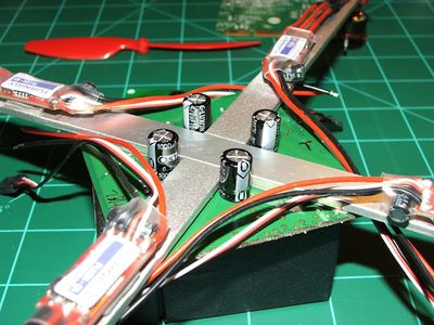

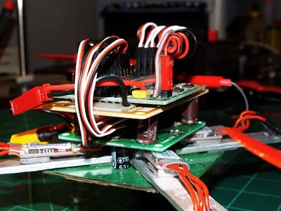

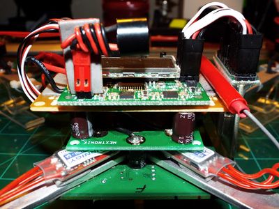

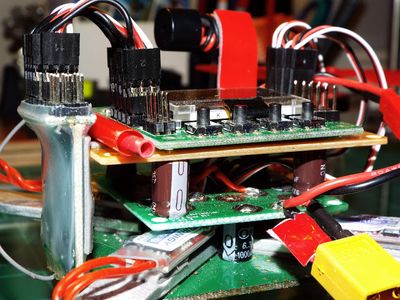

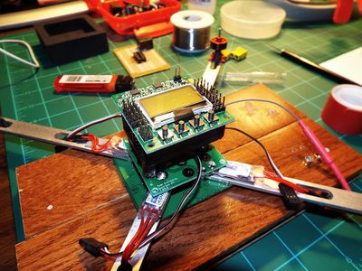

I ended up mounting the motors upward & turning the distribution board in more of an X configuration. I continued the build and glued (ca) four capacitors from a computer motherboard to the network card. Then I glued the distribution board to the top of the capacitors along with a blank circuit board onto four more capacitors. I applied a piece of double sided tape to the circuit board to hold down the foam protector that the KK2 (flight controller) board was shipped in and added a plastic electrical tape container to the bottom for the battery. I used five 1" servo leads and connected them from the KK2 to a Turnigy 9x8cv2 receiver board. Used two more capacitors and glued them to the foam and receiver board with enough clearance to still access the KK2 programming buttons. Finished up by connecting the signal leads from the esc's to the KK2 starting with 1,2,3,4. Please note that 1,3 are cw and 2,4 are ccw.

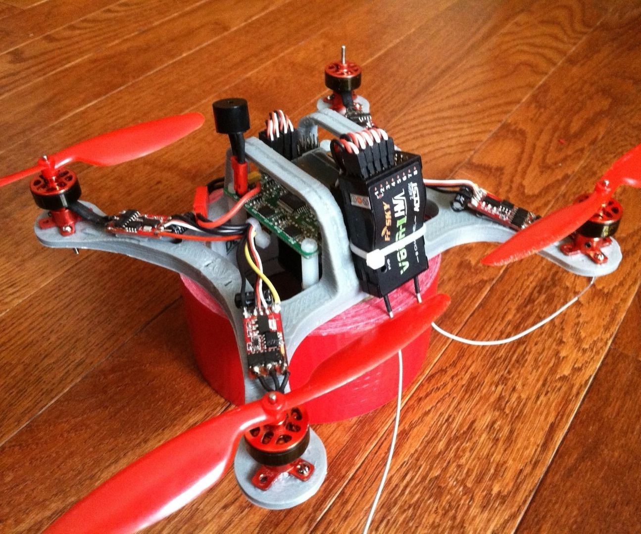

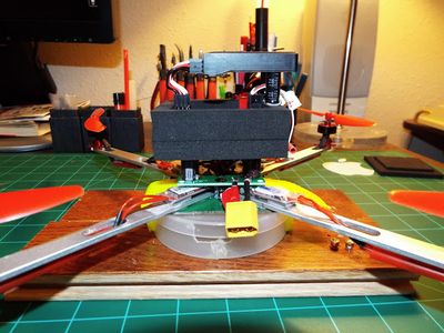

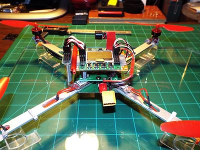

I made some mods to the design to try and make the quad lighter - removed the foam and the battery holder for starters. Took off the capacitors and used standard nylon stand off's.
I added some cheap plastic landing gear that I picked up from Party City - nifty idea - these are just plastic table cloth clips. They provide some cushion and are cheap and easy to replace.

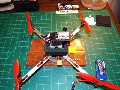

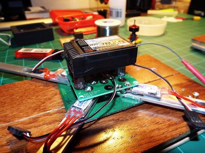

First I took off the kk2 board and the foam. Then plugged in the battery alarm onto the board. After this I soldered a female jst plug onto the bottom of the kk2. Then connected to a male jst that was then soldered to the power board. I then removed the RX module out of its shell and sealed it with clear shrink wrap and hot glued the end. All I needed to do now was to mount the rx to the kk2 board with double sided stick tape.

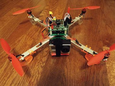

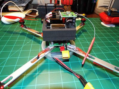

Step 5: Adding a GoPro 3

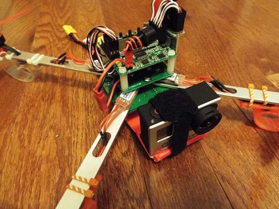

I decided to push this little quad and try my luck mounting a GoPro to it. My goal was to get some flight video. This is what I can up with - cheap piece of dollar tree foam, wire ties, and some velcro. I did not know what to expect, but the video came out pretty good; no jello or crazy vibration.
