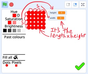

Step 6: Make It Duplicate Itself to Match the Dimensions
Next what you’ll do is make that first sprite you made duplicate itself so it matches the dimensions of what was input. The code is in the first sprite, and starts with ‘when I receive *most recent broadcast*(dimensions done for me), then ‘set drag mode not draggable’, ‘show’, and ‘point in direction *90*’ from motion. The next few parts will depend on what you think looks best for your sprite. First you need to get a ‘move __ steps’ block from motion and test how many steps looks good when it’s duplicated. To test this get a ‘create clone of myself’ block then a ‘move __ steps’ and connect them, but don’t connect it to your starting block, just leave them off to the side. Next put in a number of steps, click them to start it, and adjust the number until you find what looks best (I did 21). Now create a variable and name it “number of steps”, then drag a ‘set __ to __’ and make it set the number of steps variable to whatever you thought looked best and put that under your starting block. Then add a repeat block over the move steps and duplicate blocks (still off to the side) and set it to repeat the maximum width you had. If it doesn’t fit get a ‘set size to __%’ block from looks and find what it fits the maximum with. You may have to adjust the number of steps to fit with the new size. Now you can delete the ones off to the side. You should also get a ‘go to x y’ block and input the x and y coordinates of the starting position so it stays in the right spot.
Next create a variable called “starting x” and get the ‘set _ to _’, and from motion get the ‘x position’ block (it’s one of the round ones). Make it ‘set *starting x* to *x position* and drag it under what you already have. That’s all the setup there is that might vary depending on the person, so now I’m going to write out the whole code. It’s not actually text, I’m just writing out what the blocks used say, everything surrounded by brackets are variables and things surrounded by ** are something you picked (not what I actually wrote). Also things that are indented under a repeat mean they’re inside the repeat block. If you’re confused you can just copy the image of it. Anyways, here’s the main code.
When I receive *dimensions done/whatever the last broadcast was*:
show
point in direction 90
go to *x* *y*
set size to *size you picked*%
set (# of steps) to *the number you picked*
set (starting x) to x position
Repeat (width)
move (# of steps) steps
Repeat (height)-2
set x to (starting x)
change y by *- whatever your steps was*
Repeat (width)
Repeat (width)-1
Once you’re done it should be a square/rectangle matching the dimensions that were put in.
