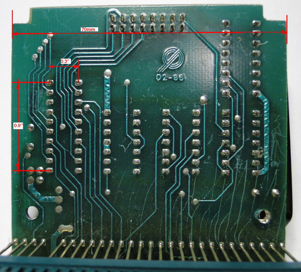

DIYable Board
A second challenge was to make this shield DIYable. It implies on a Single-Face board with as few jumpers as possible.
To achieve the single face layout I have started by choosing the place of the connectors and the light and sound sensors. Then the association of the Arduino Pins with sensors, as well as the halves of the OPAMP halves and gates of the Analog Switches were experimented until the 'ratsnet' lines showed up aa bit clean. At the end the result was achieved with only 2 jumpers.
(Note: The board available on the files has been further optimized and now only one jumper exists)
To save space and simplify the layout 2 stereo jacks have been used instead of 4 from the original design.

Step 3: Board Construction
The prototype board had been built using the 'tone transfer method'. There are several instructables teaching how to do that.
The board was etched using Ferric Chloride in a water bath to accelerate the reaction. Despite the potential of the Ferric Chloride to make a mess, I prefer to use it because the etching chemical reaction does not release gases. After corrosion the board was silver coated using TP-065E solution and then it was drilled.
Then the components have been soldered starting by the resistors, then the capacitors, followed by the IC Sockets, After that the taller components have been soldered.
Note: Due to a lack in local stock, the prototype received a different potentiometer.
Using a multimeter all the connections have been tested. I always do that before powering things up because It saves us from a lot of trouble. For example I have found a short circuit caused by a track that was too close from the pads of two resistors, but it wasn't noticed on PCB drawing tool.
(Note: The board available on the files already have this correction)
