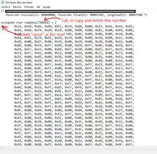

  • Open the audio file using HEX editor software, I used HxD. Select All(Ctrl+A) > Edit > Copy as > C
  • Open notepad and paste, put "cons" at the beginning of the char and cut the number of the array and add an unsigned integer with the name rawData_len at the end of the document and add the array number.

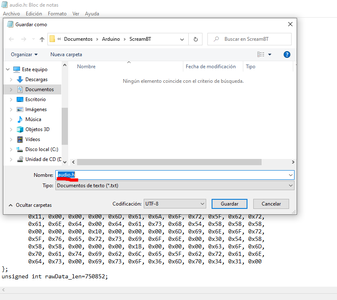

  • Save the file adding the extension .h
Example:
What you copy from HxD:
unsigned char rawData[750852] = {
0x52, 0x49, 0x46, 0x46, 0xFC, 0x74, 0x0B, 0x00, 0x57, 0x41, 0x56, 0x45,
.................................Raw Data..................................................

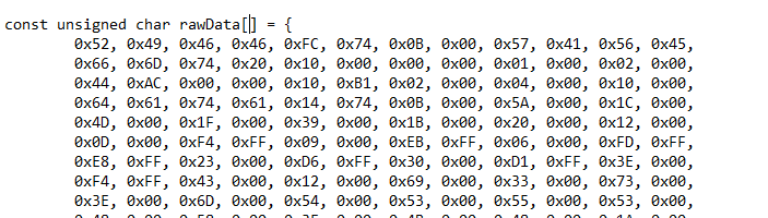

.h document:
const unsigned char rawData[] = {
unsigned int rawData_len=750852;
