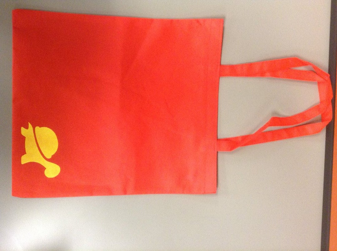

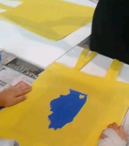

Step 5: Prepare the Tote
Lay a piece of cardboard inside your tote (this will prevent the paint from sticking inside the bag). Lay the screen on top of the tote.
Step 6: Paint!
Dab paint on one side of the design. Using a foam brush, push the paint over the design being sure to get each corner. Gently lift the screen up, and your design will appear on the tote. Allow 2 hours to dry.
