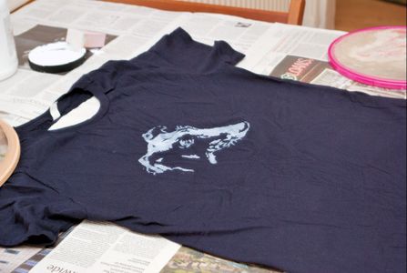

Step 2: Printing Your Image

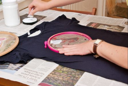

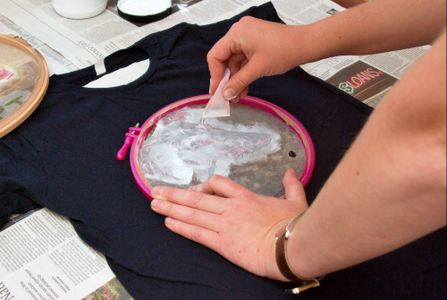

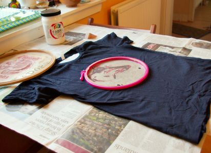

Lay flat the material onto which you wish to print your image. If, as in this case, it is a double layered item (e.g. a T-shirt), make sure you place a good layer of newspaper between the 2 layers so that the ink does not seep through onto the back layer on printing. Then position your printing screen on top of the material so that the image lies where you want it (in this case, in the middle of the chest area). Dip your sponge into the screen printing ink so that one surface is lightly coated. Then, holding your screen firmly in place with one hand, dab the sponge repeatedly onto the screen with the other. This will push the ink through the tiny mesh holes & onto your fabric.
It is best only to apply a thin layer of ink, otherwise the resulting image may be rather 'blobby'. Experience will tell you how much pressure you need to apply in order to create a clear, crisp image (I often make a test print on a scrap piece of material first). Once you have dabbed ink over all areas of the screen, lift the screen off, being careful not to smudge the image by dragging it sideways across the fabric.

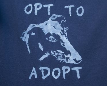

Step 3: Adding Finishing Touches
At this stage you may choose to use further screens +/- inks to embellish your image. In this case I used a separate screen (but the same ink) to add some text to my image. You can also use further screens to print additional colours onto your image (it is best to let each colour dry thoroughly before applying the next, & to print lighter colours prior to printing darker ones), but I personally prefer to leave my images in monochrome.

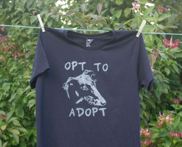

Once you are happy with your printed image, carefully remove the newspaper from behind the fabric (it may have started to adhere to the fabric a little if you have taken a long time over your printing) & hang your item up to dry for an hour or two.
