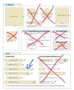

Everything crossed out in red you will not need, the Blue pointing at the letter (N) will determine the height of the table...

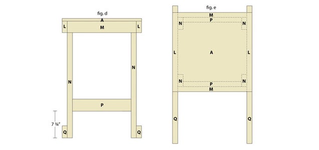

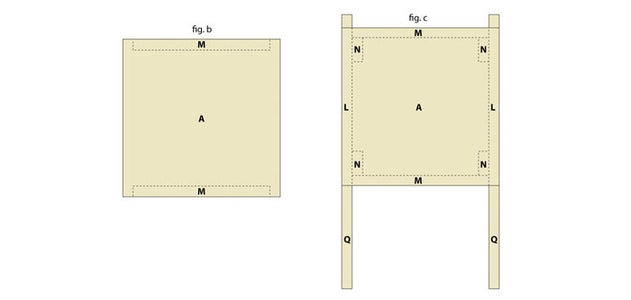

Assembly is fairly easy. You can do it yourself but in certain cases you may need a helping hand. My assembly was completed in an a hour and a half.

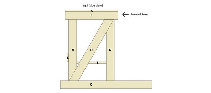

With the help of my fiance. My table does not look exactly like the diagram due to the measurement changes that I have made. Not only in the heights but in the with as well to fit my exposure unit under the table...

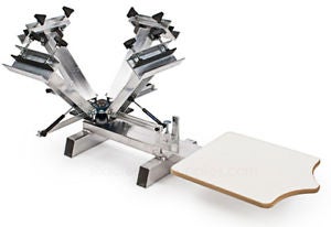

My printing press was purchased several years ago. And it can be used on any surface. But I love the way the table makes it look more professional. And with the extended wood on the bottom, I don't need to worry about pushing down on the press too hard. My press was purchased from
http://www.silkscreeningsupplies.com/
It is a
4 Color 1 Station Table Top Screen Printing Silver Press... I'm not sure this particular press is still available I think it only comes in 4 color 2 station
Tabletop now... Which is an upgraded model from what I own... With many available a upgrades.
