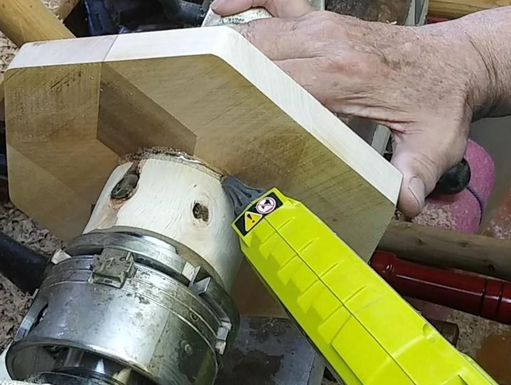

You can use a burning wire to burn some decorative lines in the handle.
Once you have the handle to the desired shape, sand through the grits to about 320 or so.
I use sanding paste as a finish for the wood.
