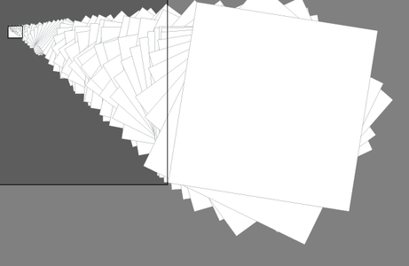

To get started, open up ExtendScript toolkit and open up Adobe illustrator. Try a simple, javascript "hello world" script by matching your settings to the ones shown in the screenshot above. The left drop down should say Illustrator CS6 and the right one should say main. The little link all the way to the left will glow green if this is done correctly.

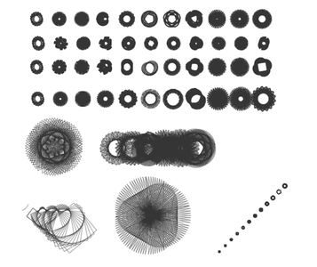

Experiment and have fun with Extend Script. You can make quick and complex vector art if you have a few moments to kill.

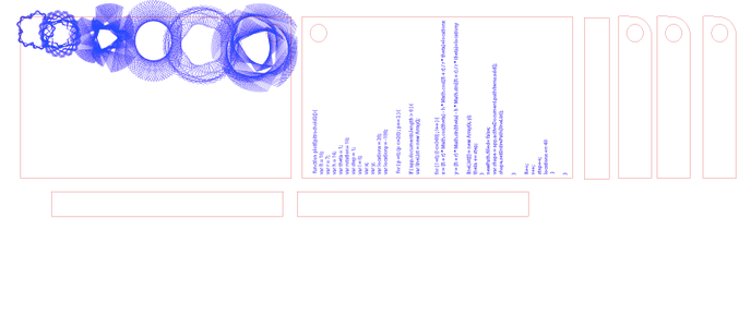

Now that you're synced up, enter the epitrochoid script into ExtendScript.
If you'd like to avoid coding, you can simply open up the vector file. Play with the settings or vector art to make something that suits you! To learn more about parametic equations and epitrochoids, Wikipedia is very helpful.

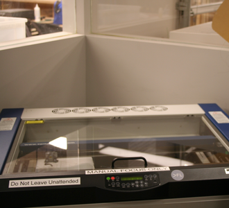

For an Epilog laser cutter, you can color code between raster and cut. Essentially, you want to raster the details and laser cut the actual wallet shapes. If you outsource, you should be able to have a pro do your settings. Make sure the raster is at least 1/4 of the normal power as these shapes have hundreds of lines and will chew up the acrylic otherwise (see above).
