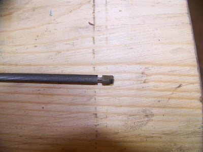

Use cutoff saw to cut the chain saw file to about the same length as a scroll saw blade.
Step 3: Grind Slots
Set up in a lathe and grind slots at each end of the file to fit the .080 " opening in the blade bracket.
Step 4: Grind Flats If Required
Because of the design in my blade holders I had to put some small parallel flats on each side of the file ends.

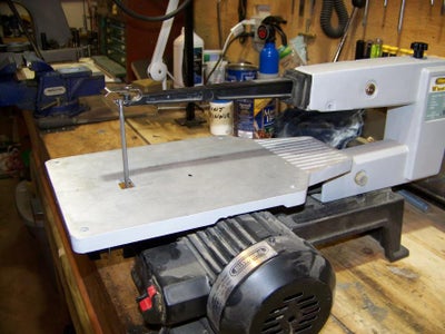

Step 5: Install the Chainsaw File
Place the file in the blade holder brackets with the file cutting action working on the down stroke and apply tension with the blade tension adjusting screw. Stand clear when first turning the scroll saw on to make sure all is secured well.
Note:
After modifying the blade holder brackets my scroll saw blades still fit the same and work just as well.
