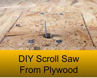

I have always wanted a scroll saw for some smaller projects, but a decent sized one is pretty expensive. That's why I made my own from a cheap jigsaw and piece of plywood. I literally put $25 into this. The plywood was scrap, and the hardware was just laying around. The Jigsaw and blades were the only expenses for me.

Step 7: Mount Jigsaw Base to Wood Base
Using an allen key, unscrew the jigsaw's base using the angle adjusting bolts. After completely removing the base plate, make sure it will fit on a 6"x6" square, and mark 4 holes in the corners. Using a standard 1/4" drill bit, drill out those holes. Make sure your 1/4" bolts will fit.
Next, align the jigsaw base on the wood base and drill the bolt holes into the wood. Remove the jigsaw base from the wood base, and put a 1/2" bit on the drill. Flip over the wood base and drill about HALFWAY through the wood, following the 1/4" holes.
Next, insert your bolts through the jigsaw and wood bases, and mark the woodline on the bolts. Take them out, and use the hacksaw to cut that line. After cutting, file the edge, and test the threads with a nut. If it screws freely, re-insert the bolts into the bases, press a nut in the 1/2" hole, and tighten everything down. The top of the bolts should be flush with the top of the wood.
Check that everything is tight and flush, and then mark the hole for the blade. I found that a 1/2" hole was big enough, but you may need to go bigger.
Step 8: Re-attach Jigsaw to Base
The last step is to re-mount the jigsaw to the base. I had to drill 2 small 1/16" holes in the base for the allen key to go through, but you may be able to do tighten the bolts from the sides. Make sure that jigsaw isn't mounted at an angle, as that will show in your cuts.

You're almost done! All that's left to do is mount the saw to the table. Flip the tool locks in, and slide the saw up through the hole. Twist the tool locks back out, and make sure everything is stable. Next, plug in your jigsaw, and turn it on. Mine has a power lock switch, which is great for this application. If yours doesn't have one, just lock the switch on somehow. I would just zip-tie it. This is like a cross between a table saw and a scroll saw, so keep your fingers away from the blade!
Use a piece of scrap wood to test the saw. Slowly push it toward the blade, and hold it firmly. If that was successful, try cutting out a more complicated pattern. This is a great tool to have around, and you will be seeing it in future projects.
