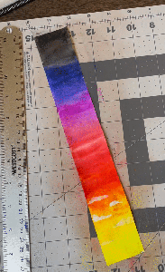

Step 5: Paint the Backdrop
For this project, the background is a sunset image. Plan out how you'd like your image to change as your scroll through it. Consider how much of the image will be showing at once.
For this painting, I used gouache paints to create a gradient wash of different colors. If you are using gouache or watercolors, let the wash completely dry before painting anything on top of it.
For the clouds, I used watered-down white acrylic paint.

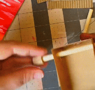

Step 8: Insert Pegs

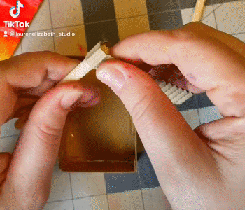

Take your peg and a 0.5" wide piece of the corrugated paper. Glue the end of the paper to the peg, roll it up and glue in place.
Gently push the peg through the punched holes.
Repeat with the second peg.

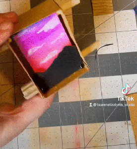

Step 10: Add Foreground Decorations
Glue in your foreground objects, being careful to not get any glue on the background scroll. You can add them in multiple layers, like I did, or just attach them directly to the back of the frame.
Step 11: Attach Front Frame
Glue your front frame piece on. Take your time to keep the glue all on the inside.

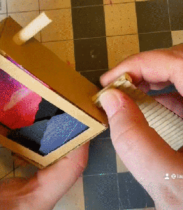

Step 12: Finish Handles
Attach the corrugated paper to the other side of the handles the same way you did the first side.

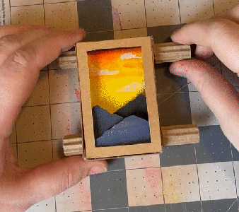

Step 13: All Done!
You did it! Scroll through your art piece and enjoy!
There are so many things you could make with this by changing the size of the box, what you paint in the background, and your foreground objects!
