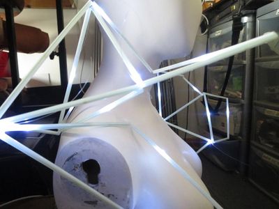

Step 1: Size and Scale
First we rummaged together anything clear/white/transparent tube/bead/metallic-ish, some micro LED lights and fishing line to string it all together. Almost everything was white or metallic, no colours. Everything wanted to be architectural and neutral, the only colour would be from the light. Melissa had some copper tubes, and I had some hair beads. The only thing missing was clear straws.
We started by randomly stringing together fishing line and white plastic straws [so there was no strain on the LEDs] and the light shone through, which looked kinda cool! It was bright in the studio, so a bunch of time was spent crouched behind the table to see the lights better.
Deciding the lengths of the straws came first as that changes the scale a lot.
I started out just using the whole straw [minus the bendy bit] to see how the LEDs looked inside the straws and at the junctions. It looked really cool, but the scale was probably a bit unwieldy to wear on stage.
So we measured between the lights and cut the straws to that length, so each light would be at a junction. The straws were then threaded with a light between each one.

The most important thing about designing with light is that you need to see the thing lit as quickly as possible, because it looks so different. So we used those tiny cheap micro LEDs that seem to always be kicking about somewhere. I had some programmable ones, so we could also play with speed settings and see basic animation.
We used sticky copper electronics tape to cover one half of the beads so we could direct the light. The tape needed to block - and reflect - the light, so copper tape was the best choice. Silver foil would have been prettier but it would have taken longer and we didn't wanna use glue! We didn't use this method in the final design, but this prototyping made us understand how best to design for directional light. This process meant we could test how it would look really quickly.
Our final design required diffusion, because the lights would need to be much bigger and more powerful to be visible on stage. So we had to imagine things bigger and brighter as we played about.

Step 4: Arrange the Final Design and Turn Out the Lights!
The final design became a hybrid of the two aesthetics in the images: clear, chunky, transparent diffusion + slimmer, solid copper structure. I guess that means our experiment was a success!
Our final design had a soldered metal 'jewellery' base which sat on the shoulders and branched out at the top, All the complex programmable electronics were in there and the LEDs were soldered externally.
The clear construction [no electronics] went on top and could be styled and changed to go with Imogen's outfit. The clear part could now be completely swapped out for a different piece, changing the aesthetic.
These pictures show the initial structure we used to design the jewellery base. It perches on the shoulders, like an oversized necklace. This can be done simply by twisting up craft wire and making sure there's no sharp edges. Or soldered, as we did, if that's your jam.
Then, the light, transparent plastic pieces can be styled over the top. Super easy to wear if you just have a battery pack in your pocket. The whole thing is physically light [as in weightless] so it's a really fun and quick way to make a dramatic costume.
