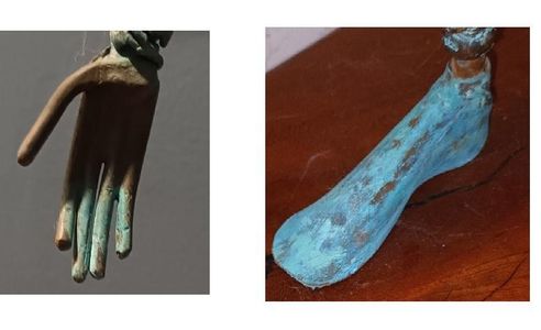

Step 6: Making Hands and Feet
If you are brazing the parts with a torch, you might want to make realistic hands. I take heavy 10 gauge wire cut 4 fingers and thumb and then braze them in a rough hand shape. After each cools, I will use pliers/files to adjust the finger length and bend them to look natural, then braze them on to the end of each arm. If you just going to wrap the figure then create a small ball of wire wrapping and glue them into the end of each arm tube.
For feet I cut some 3/4" copper and flattened into some sheets about 3" long. I then cut out a "shoe upper" design and bent them into final shape around 3/8" drill bit.

Step 10: Optional - Easy Patina for Copper
I happen to like the patina of aged copper, so prior to assembly I will put on a chemical patina to help it "age" faster. This process works well for indoor items but it only helps the process for garden art. There are many patina finished that are better but this is easy and achievable with grocery store items.
The process involves submerging the part in nothing more than pickling vinegar (10%) for a couple of hours.
I use a tube made from plastic drain pipe, submerge it for a couple of hours, then remove it and let it stand to dry. When you first remove it should be a dull reddish copper, but as the liquid evaporates the green colour will appear.
Step 11: Giving It a Head
For this sculpture I simply used air dry clay and molded a head form that I liked for the size of the body. After it dried I drilled a 3/8" hole and placed it on the copper neck post. I then painted it with cheap acrylic paints to match the patina colours on the body
