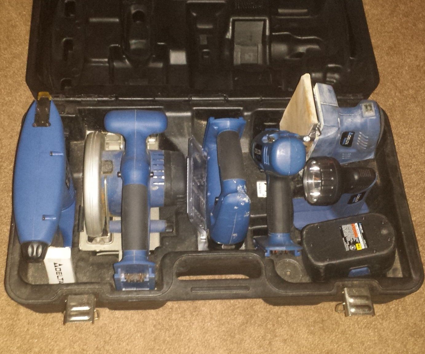

In this instructable I will show you how to build a sealed battery box. It's not completely water tight but rain is no problem for it. Since building this I have found it to be a great mobile power supply for many things even running power tools while camping where there are no electric hookups.

Congrats! If nothing burned then you did it right! Feel free to adapt all sorts of things to that like an Ebike or a drill or anything you like!
