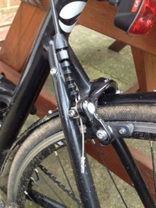

Step 2: Brake Cables
Brake cables were super easy as the only exposed piece of inner cable was on top tube (pic 4). So, same technique been applied. Both ends nosed ferrules plus a bit of pipe in between. I was quite lucky and I found a piece of pneumatic hose almost exactly same inner dimension as nose of the ferrules. Anyway, Nokon selling same type liner for brakes (http://www.nokon.com/NokonUSA_Products%20%28black%29.htm), and with two pieces of heat-shrink (same as with gear cables) will do the job.
As last thing I've put rubber dust covers from V-brakes on a adjuster threads, and that covers last exposed part of inner cable (pics 5, 6, 7, 8).
