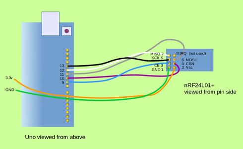

Step 8: Speaking of Remote Control...
Let's make a remote control to move our robot manually!
Step ingredients:
- Arduino Uno
- nRF24L01+ module (recommended with no power amplifier module)
- 7 female-male wires
We are going to do a very similar setup to adding RF capabilities to the robot, we just the ribbon to the Uno on different pins. Borrowing again from Robin2's excellent blog post, follow the schematic to precisely wire the RF24 module to the RC Uno.
Note: In the above "after plugging in" picture you'll see a joystick in the background. Ignore that for now! It's coming up :)

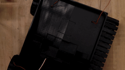

- It's time to put that TPU to use! Arrange as many single tracks as you can on the MK4 printer during slicing - you're going to need 90 of them (don't forget to use the Bambu glue on the build plate as mentioned in the intro)! After they're all printed, clear out the tiny spaces of supports in each piece, then merge them together in a track-like fashion. 1 screw on either side of each track connection will connect them (hence the 180 screws).
For the basket, use superglue to attach all the pieces together. Once you've done that, drop it in the huge basket-shaped slot at the bottom of the robot! Next, attach the wheels to each motor. Make sure to orient them to attach correctly (there's a flat portion on each wheel connector that corresponds to a flat portion on the motor spoke). Next, wrap the tracks around each set of wheels to attach them to the wheels - see the GIF to see how to lay it out and assemble. Finally, assemble the electronics layer like the sifter layer - each piece will fit into one another and adhere with sifter glue. Place the completed layer on top of the sifter layer, pulling the wires through the holes. Ensure to orient this layer such that the part with the small rectangular slot is above the servo and ensure to pull the servo wire up as well. Whew! Almost done!
