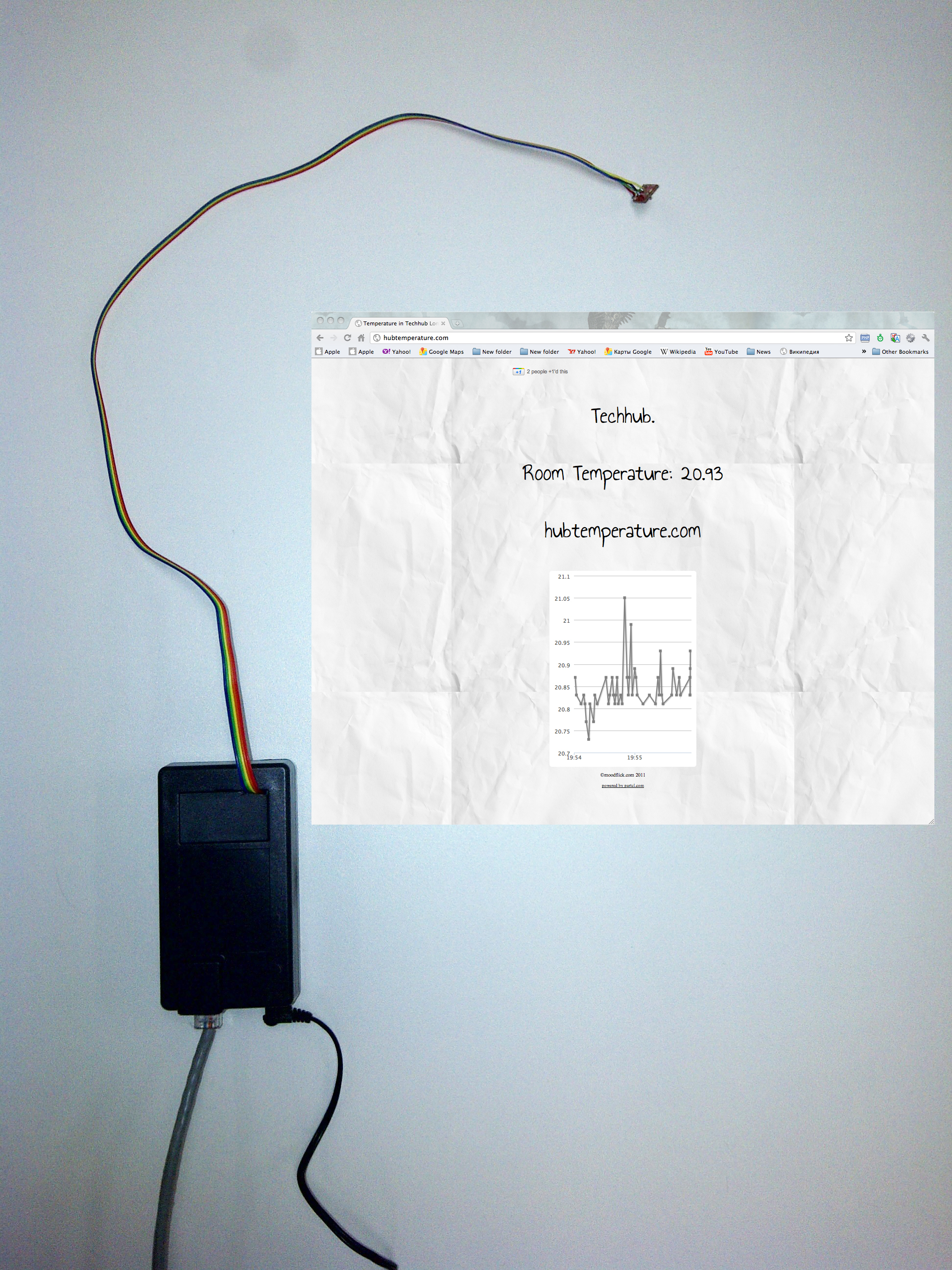

Step 2: Soldering It All Together
You can use a board or just solder the wires together like I did.
Then pack it all in a project box. I placed the transistor outside to cool it down a bit and to prevent the box from overheating.
