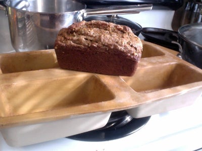

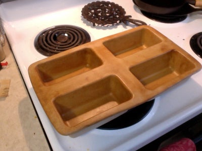

Step 6. Remove, and notice the nice, evenly brown patina. It looks like your pan spent a weekend in the Bahamas. You may have a few darker or lighter areas. The more even the coating, the more even the color. it should not feel sticky or oily, because the oil has polymerized and formed a hard, thin layer.
Step 7. Repeat steps 2-6 at least 3 times. As layers build up the pan will gain a slick, hard semi-gloss caramel colored finish that would otherwise take many uses to create.
