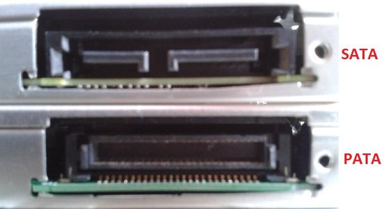

Step 3: Measure the Optical Drive
Get a ruler and measure the height of the optical drive. This is often 12.7mm or 9.5mm.
Also, make sure that your optical drive is a SATA drive (as seen in the pictures).
SATA: Serial AT Attachment
PATA: Parallel AT Attachment

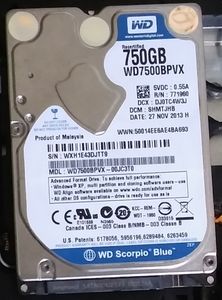

Step 6: Insert HDD
Insert the HDD or SSD in the caddy, and screw it the screws in.
I like to have the fastest drive (on which my OS (windows) is installed) (SSD) in the place that the HDD was when I bought my laptop, but my HDD was too thick for my caddy, so I put my SSD in it.
