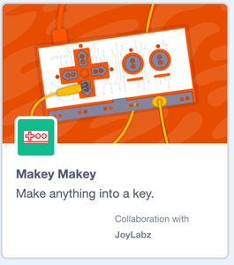

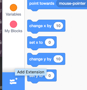

In Scratch 3.0, click on Extensions and add the Makey Makey extension to your current project. After you add the extension, you'll see the Makey Makey logo beneath "My blocks."

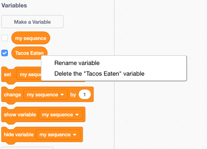

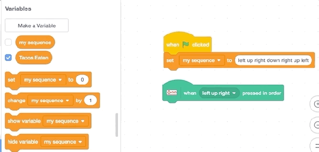

In the variable palette, create a variable for your secret code. Drag a "Set variable to____" to your workspace and connect it to a "When Green Flag Clicked" block (Picture 1). Inside the blank, type the code you want to be your secret code. For our game, we used "left up right down right up left" as our secret code. Rename or delete this block by right clicking on the variable. (Picture 2)
In the next step, we will drag the "my sequence" block into the Makey Makey extension block.

Once you've created a sequence, it is really easy to drag it into the adjustable spot in the Makey Makey block: "When ____ pressed in order"

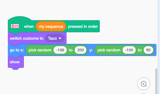

In our example game, this secret code makes tacos appear randomly on the screen (Code in Picture 1.) The game's objective is for the bear to eat the tacos!
When the bear touches the taco, the costume changes and it sounds like the bear is eating the taco. (Eating Taco Code in Picture 2.)

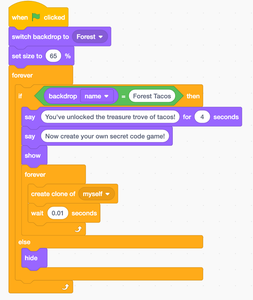

We also created a "tacos eaten" variable to track how many tacos the bear eats. Once he eats enough tacos, the variable will signal the end of the game and trigger an eternal taco rain! (Trigger Code in Picture 3 and Taco Wizard signals you to create your own game in Picture 4.)
See the next step for raining taco code!
Step 7: Bonus: Raining Tacos?
Thanks to firefang16 for the original raining taco code!
In our game, we have the taco clone begin once the variable trigger reaches the correct number. To have a "raining taco" effect, we used this code from firefang16!
