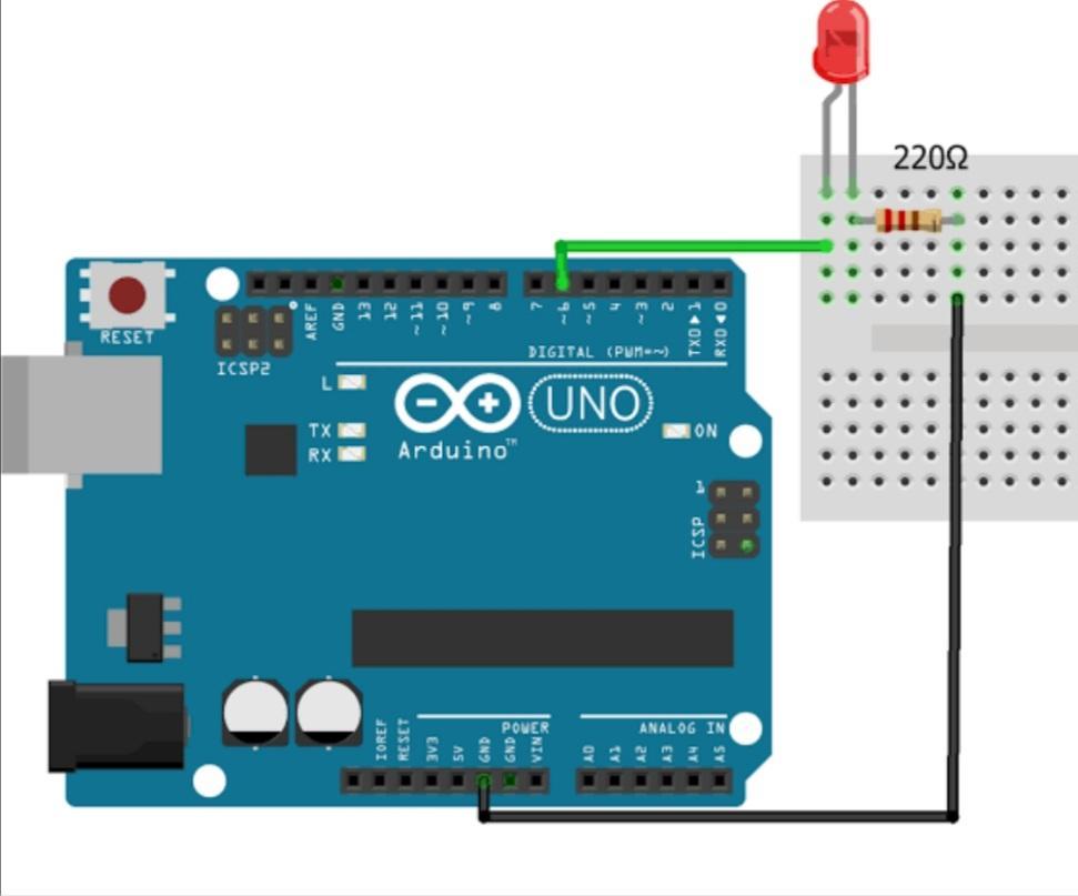

Step 2: Circuit Connection
I have made the circuit connection in the fritzing software. So, I am giving both the fritzing and Image file.
