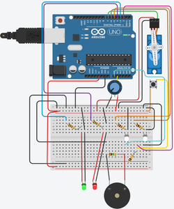

The original Makers instruction guide presented a wiring diagram for a perf board. Since breadboards are more commonly used and require less experience to assemble, we have incorporated a schematic diagram of a breadboard circuit along with a more comprehensive general circuit diagram.
The electronics above show the use of both male and female wires. Use as needed per the diagram. There are some important reminders.
Remember to input the LEDs at the correct orientation (positive and negative). As a reminder, all general LEDs have a slight flat edge and a round edge. Make sure the negative flow connects to the flat side whereas the positive connects to the round.
The potentiometer is important to set the strength of the knock required to set off the Piezo sensor. Rotate counterclockwise to increase the resistance, requiring a more powerful knock. Rotate clockwise to decrease the resistance value. Be careful: having the resistance value too low will set off the piezo at any slight movement, making the machine impossible to use. For this reason, err on the side of a higher resistance.
The resistors we are using are as follows:
Finally, while copying the circuit layout, always beware of any short circuits that may occur from crossing wires. Be sure to also check each output and be sure it is responsive.

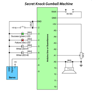

The above schematic may be helpful to more simply understand what connections are being made in the circuit. The hardest part to understand is the wire connection from A1 to the 10K ohm resistor. This is actually the potentiometer transmitting the output to A1. The symbol with three descending lines of smaller lengths signifies the ground. The Switch is indicated by the horizontal line with a small vertical line off center toward the 5v. This part of the circuit will allow you to program your secret knock.
