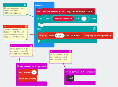

(Microsoft Make Code required) The software requires pretty simple code. First, you need to drag out a "forever loop" event handler. Then set a variable for the motion sensor. After, you'll need an if else statement. This is the majority of your code. Leave the if section blank and put the sound you want to play after triggered in the else section. The alarm (after triggered) won't stop playing, so you have to drag out an input block. In the event handler, set the volume to zero, and also tell it to stop all sounds. To rearm the safe, insert an input block for button B, and code it to reset. Afterwards, make sure your code matches the image above, then you should be all set (coding wise).

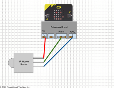

When you assemble the Hardware, make sure you follow the wiring diagram above. This project requires an extension board to use it. First, you take a wire (all wires used were Female to Female) and attach it to the 5V pin for power. Connect that to one of the three pins on the IR sensor. Then, take another wire, and attach that to one of the digital pins (we chose pin 8). Connect that to the IR Sensor. Finally, take a wire and attach that to the ground pin. Hook it up to the Micro Bit, then you should be all set.
