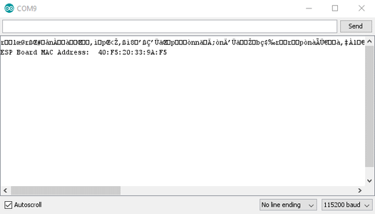

Step 2: Get the MAC Address of the Receiver Board
To get the MAC address of the board upload this code to the board.
#include <ESP8266WiFi.h>
void setup(){
Serial.begin(115200);
Serial.println();
Serial.print("ESP Board MAC Address:  ");
Serial.println(WiFi.macAddress());
void loop(){
Then open the serial monitor, and reboot the board.
If done correctly, you should see the MAC address in the console.
The MAC address of this board is 40:F5:20:33:9A:F5

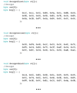

Step 8: Generate the Keys
You can throw dice or use "dice throwing software" or hash the picture. I've decided to hash the photo because this is the quickest method.
To make it easier, copy this array three times and replace Fs with your values.
Note that the key is in hexadecimal format.
  byte key[] = {
                  0xFF, 0xFF, 0xFF, 0xFF, 0xFF, 0xFF, 0xFF, 0xFF,
I've used this photo as an input: https://images.pexels.com/photos/8538496/pexels-ph..
Hashed it here: https://md5file.com/calculator
And obtained this output:
1c1152b89a61eb609e55059de57e38e98a2bf76ad98c5c5658f451c53364c76f8c4d0792faf54339cdc54453150aea21402e58d8109985992740292405e01d99

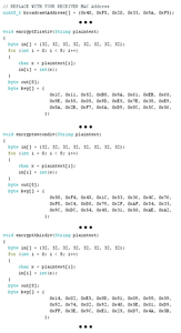

Step 9: Modify the Receiver's Firmware
Open the sketch in the folder
\Secure_4-channel_Wireless_Switch-main\Secure_4-channel_Wireless_Switch_Receiver.
Replace the three keys in this sketch with the ones you've generated.
Step 10: Modify the Transmitter's Firmware
Open the sketch in the folder \Secure_4-channel_Wireless_Switch-main\Secure_4-channel_Wireless_Switch_Transmitter. Replace the receiver's MAC address with the one you've obtained from the step 2, and then replace the three keys in this sketch with the ones you've generated in the same order you did in the previous step.

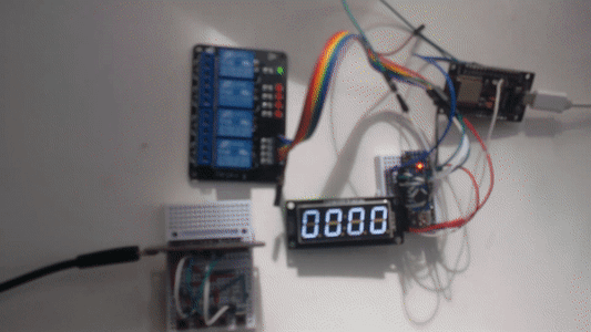

Step 18: Build the Receiving Part of the Device
Since the schematic depiction of a 4-relay module doesn't exist, I've only added a circuit diagram.
Step 19: Circuit Diagram for the Receiving Part

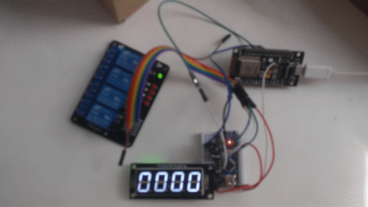

Step 20: Test the Device in Normal Conditions

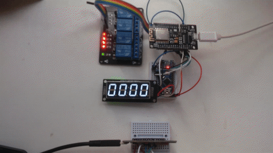

Step 21: Build the Trash Sender *optional
Let's suppose that the attacker somehow discovered the MAC address of the device.
Every time there's an unsuccessful attempt to attack the device, the number in the display will increment.
You don't need to connect anything to the trash sender aside from the power supply.
Step 22: Test the Device Under Attack *optional
