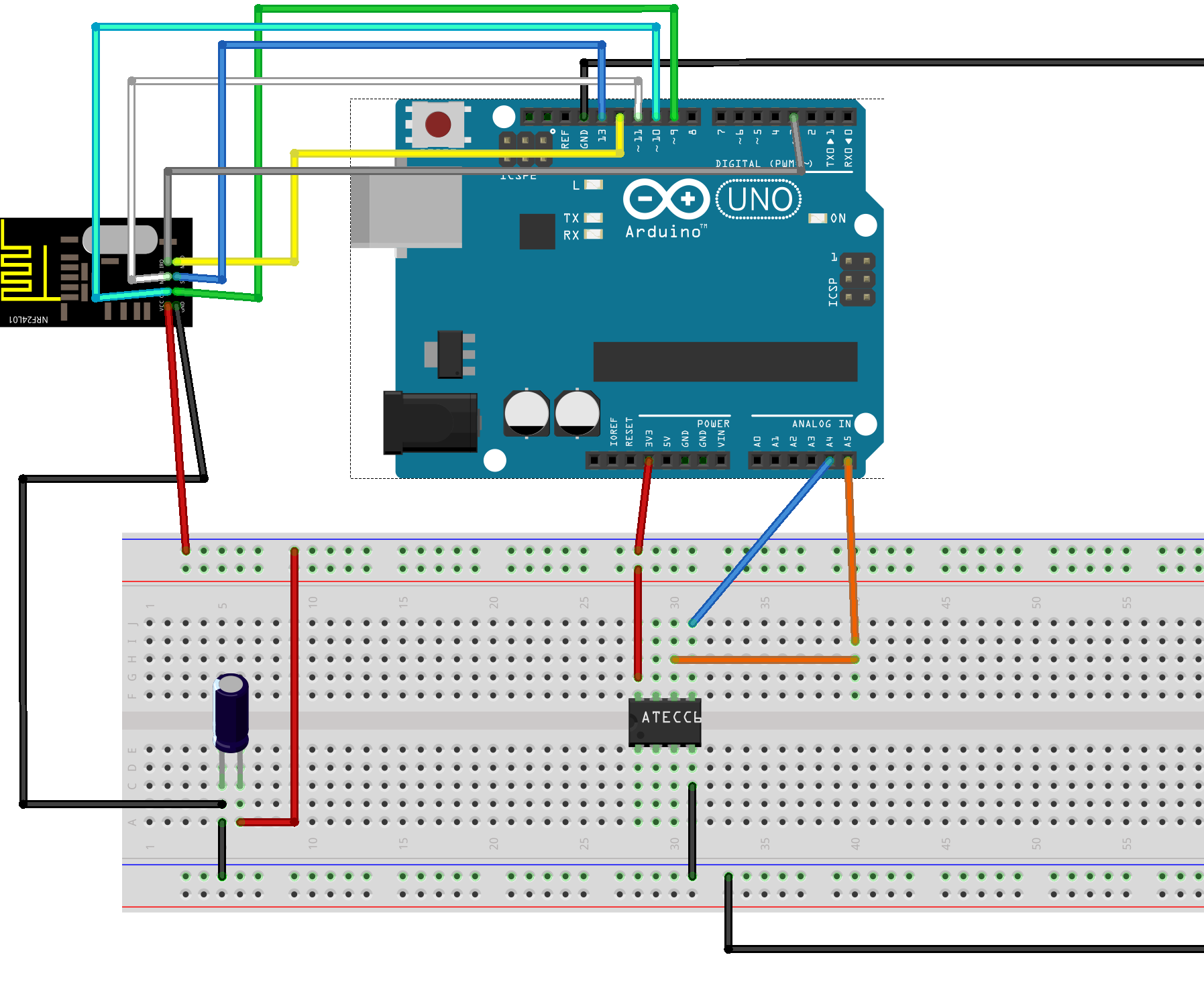

Step 3: 1. Desing of the Circuit
1. Design of the circuit
The schema of this circuit is very simple!
You need to use 3.3V power because the recommendation is between 2.0V and 5.5V but I preferred use the 3.3V.
For this chip, normally you have a dot on a corner of the chip, this dot is the Pin 1 of this board. I added the Top view of the Atecc608a with PIN Number because it is a 8-Lead SOIC so the chip is very small.
- ARDUINO 3.3V -> PIN 8 (Atecc608a)
- ARDUINO GND -> PIN 4 (Atecc608a)
- ARDUINO A4 (SDL) -> PIN 5 (Atecc608a)
- ARDUINO A5 (SCL) -> PIN 6 (Atecc608a)
I added the Top view of the Atecc608a because it is a 8-Lead SOIC so the chip is very small. If you prefer, so suppliers build some board with the chip solder, it could be easier for you.
Warning : In my case, I have to add a resistor between the SDA of the Arduino and the Chip (also for the SDL). I added a 4.7Kohm resistor for each.
