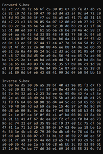

Step 1: Rijndael Substitution Boxes
Rijndael cipher (Advanced Encryption Standard) has two substitution boxes which are the inverses of each other. Rijndael S-Box takes 8-bit input and produces 8-bit output.

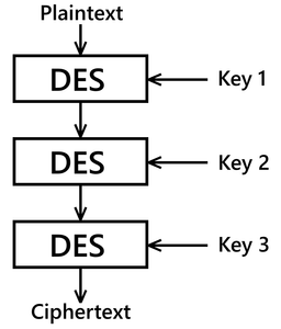

Step 3: 3DES
Triple-DES is an attempt to eliminate the main weakness of the DES by simply tripling it.

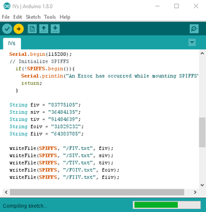

Step 8: Generate the IVs
There are lots of methods to generate a random number. I've decided to throw 20-sided dice to do this. Every time I was getting a number with two digits, I was writing down the last digit.
By the way, involving your pets in the IV generation process can add more randomness.
Eventually, I've generated these five 8-digit numbers:
83775105
36484135
91484639
31829232
64383785
The maximum value of IV is 99999999. If you've generated something more than 99000000, I would advise you to either change the first digit or generate the new IV.

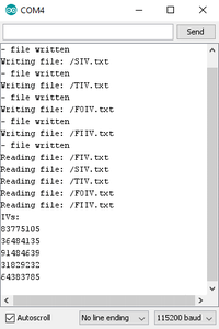

Step 9: Upload the IVs Into Both ESPs
Open the sketch called IVs and replace the IVs in this sketch with the ones you've generated.
If you did everything right, you should see the IVs in the Serial Monitor.

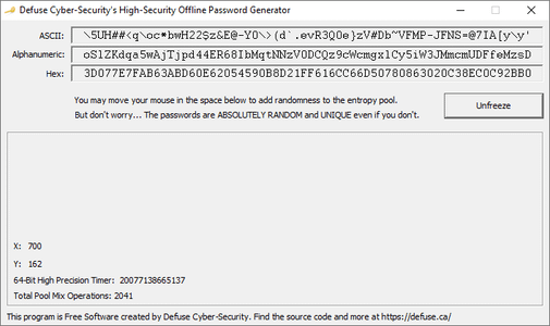

Step 10: Generate the Keys
You can throw dice or use "dice throwing software" or hash the picture.
To make it easier, copy this array four times and replace Fs with your values.
Note that the key is in hexadecimal format.
  byte key[] = {                   0xFF, 0xFF, 0xFF, 0xFF, 0xFF, 0xFF, 0xFF, 0xFF,                  0xFF, 0xFF, 0xFF, 0xFF, 0xFF, 0xFF, 0xFF, 0xFF,                  0xFF, 0xFF, 0xFF, 0xFF, 0xFF, 0xFF, 0xFF, 0xFF,		};

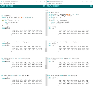

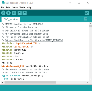

Step 11: Modify the Firmware
Open the files ESP_transmitter.ino and ESP_receiver.ino
Replace the receiver's MAC address in the sketch ESP_transmitter.ino with your MAC address.
uint8_t broadcastAddress[] = {0x5C, 0xCF, 0x7F, 0xFD, 0x85, 0x1D};
Replace the keys in the firmware with the ones you've generated.

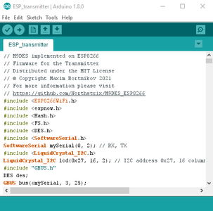

Step 12: Flash the Transmitter Board
If the firmware doesn't compile extract the content of the GyverBus-main.zip into the folders Firmware_for_Arduino and ESP_transmitter.
Step 13: Flash the Receiver Board

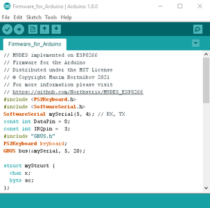

Step 14: Flash the Arduino

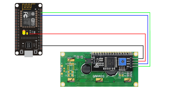

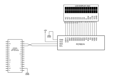

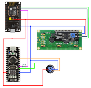

Step 15: Build the Transmitter
You can find a Schematic diagram for the transmitter in step 16.
You can find a Circuit diagram for the transmitter in step 17.
Step 16: Schematic Diagram
Step 17: Circuit Diagram

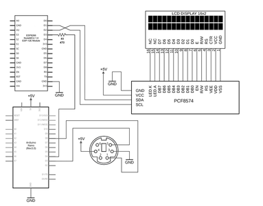

Step 18: Build the Receiver
You can find a Schematic diagram for the receiver in step 19.
You can find a Circuit diagram for the receiver in step 20.
Step 19: Schematic Diagram
Step 20: Circuit Diagram
