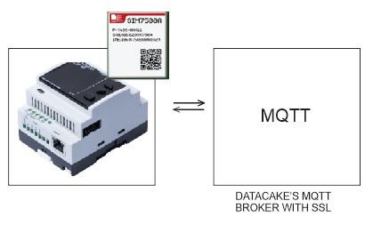

Setting Up NORVI GSM series SIM7500 to MQTT SSL
Here we’ll be considering the NORVI GSM series SIM7500 device as a Publisher and “MQTT.FX” software as the Subscriber. With the NORVI device, we’ll be storing the I/O values in the MQTT Subscriber and the data visualization platform.

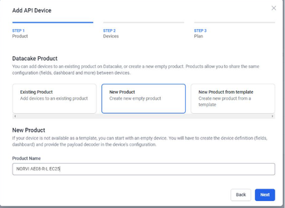

  1. Access the DATACAKE from this link and navigate the Datacake dashboard. Select the “Add Devices.
Step 8: Add API Device
