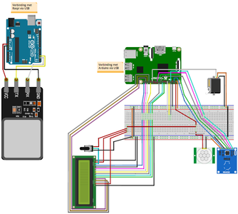

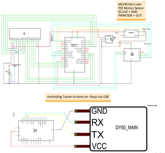

Step 1: Schematics
All schematics were made using Fritzing.
The colors used in the schematics are:
  • Red = 5V
  • Orange = 3.3V
  • Black = GND
  • Separate color = each device
Once you have acquired all the components, you can connect these to each other.
Follow the schematic closely and make sure you connect the components to the correct GPIO-pins of the Raspberry Pi and the correct Arduino-pins. This way you will avoid problems if you want to use the code mentioned below.
Make sure all components use the 3.3V and 5V from an outside power source and not the Raspberry Pi. This way you avoid damaging components and the Pi.
Below are the schematics in .pdf format if you want a closer look.

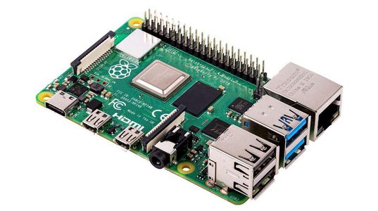

Step 3: Getting the Raspberry Pi Ready
ore we can begin to program, we will have to configure the Raspberry Pi.
1) Raspberry Pi OS.
Go to Raspberry Pi OS and download the image --> (Raspberry Pi OS with desktop). This may take a while.
2) Writing image to SD Card:
When the OS is finished downloading, you can write the image to your sd card with (recommend 8 or 16GB) Win32 Disk Imager.
3) Insert SD card in the Pi and First connection
Make a first Putty SSH-connection with the PI to get access.

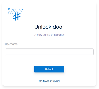

Unlock
Secure sharp is a multi-factor authentication security system. This means that it uses multiple electronic authentification methods (4 in this case).

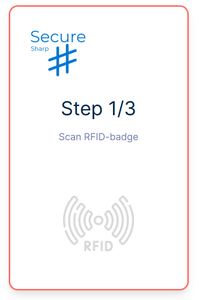

1) Username
First the user will have to enter a valid username (these are comprised of a users name and surname <namesurname>
2) RFID
When a valid username is entered, the user will have to scan his personal RFID-badge.
3) Fingerprint
After scanning a valid RFID-badge, the user will have to scan his fingerprint.

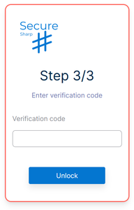

4) Verification code
Finally, when all previous steps are successful, the user will have to enter his one-time use verification code which will automatically be send when step 3) Fingerprint is successful.
