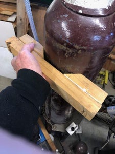

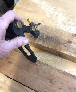

I have made a couple of these before. Then I scribed an arc and followed it with a bandsaw. See the first photo. But, the rubber tires on my inexpensive bandsaw broke apart and I cannot use my bandsaw right now. The first photo shows a compass with the center for it planted on a piece of lumber the same thickness as that which I am marking. The center of the arc should be about 6 inches from either end of a piece about 12 inches long. Cut it with a bandsaw or a jigsaw.

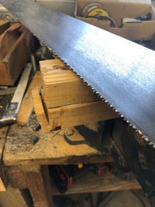

I am also showing how to do this project with the simplest tools possible. I measured and used a square to mark so I could saw by hand to get a piece of 2 x 2 about 12 inches long. See the second photo.

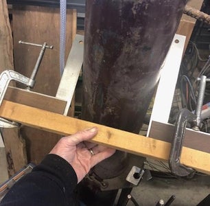

Step 2: The Diameter of the Tank
I want to know the diameter of the tank. I used two “C” clamps to fasten two squares to a piece of lumber and positioned the squares so their blades lightly touch the sides of the tank. The diameter of this tank is a very tiny bit more than 7 inches.
The photo in the Introduction shows my first attempt. I cut an arc with a bandsaw. It was also cut for a slightly larger tank. But, after a couple of years my supplier discontinued that larger tank. My tank support still works well.
Another way to calculate the tank diameter is to wrap a string or a tape measure around the tank once and divide by π or 3.14.

I used a 45 degree angle on a speed square to cut two blocks like you see in the second photo.

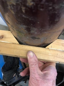

Step 6: Check the Fit
Ideally, the tank touches the support at three points: two sides and the bottom. Even if the support is a little loose fitting, it will work just fine.
