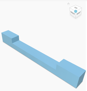

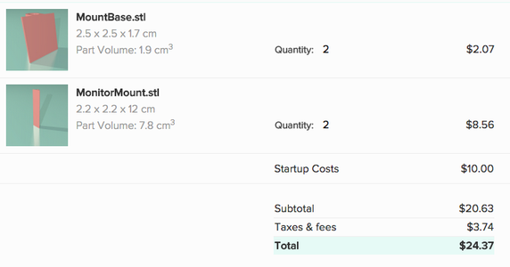

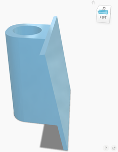

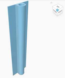

Step 2: 3D Printing
3D printing was amazingly inexpensive, quick, and convenient.
- The original STL files for the project are available on github.
- I used 123D Design, which is a free (i.e. basic) designer made by Autodesk. It worked well enough, but the native Mac app was a little buggy, so I would suggest checking out some of the standard modelers like 3dtin, Sketchup, or OpenSCAD.
- Initial iterations of the brackets did not include the extended wings, but it became very apparent that I was going to need to increase the surface area in order to get a firm bond.
- The print material is PLA and was produced on a MakerGear M2 (medium resolution).
- The 3D Hub I chose had everything printed and ready for pickup in 36 hours.
