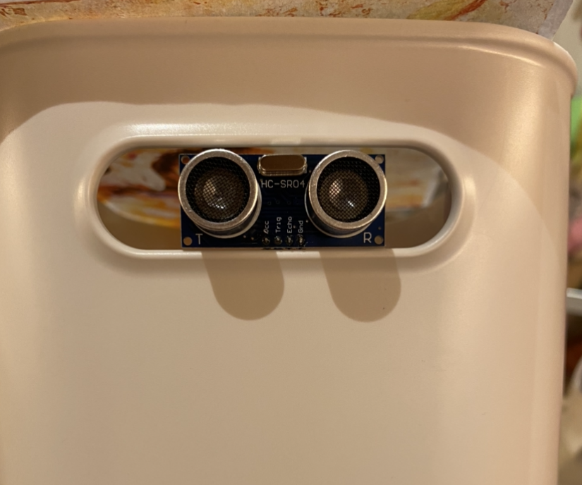

In this Instructables page, I will tell you how to make a security alarm or parking sensor with Arduino. This device can be used as a security alarm or a parking senor because it is a device that will detect how close you are to an object, the led will shine faster if the object gets closer, and there will be an LCD board that will say how close you are with the object. The materials you will need is in the supplies section.

- Sensor: Vcc to positive Gnd to negative Trig to digital pin 9 Echo to digital pin 10
