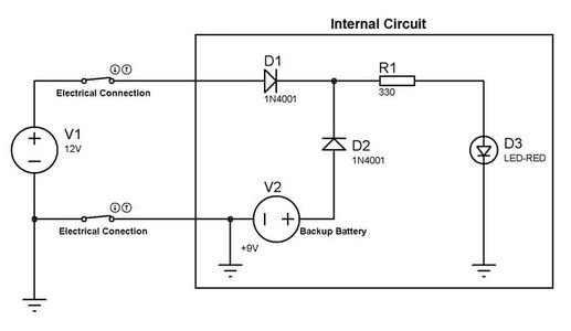

To avoid this problem, I want to propose a simple circuit and low cost, to ensure electrical power for your electronic projects.
As you can see in Figure 1, we have power supplies. The V1 power supply is used to represent the main power source of the electrical circuit. The V2 power supply is our backup battery.
It is used to supply electrical power to the LED when the V1 power source is not connected. The LED is used to represent the charge of the circuit, but you can change for anyone another electronic device, for example, the presence sensor, security system, and others.
Step 3: Circuit Operation
When the voltage source V1 is connected to the electrical circuit, the diode D1 is directly polarized and the diode D2 is inversely polarized. In this first case, the electric current will flow through the diode D1.
In the second case, as is presented in Figure 2, when the V1 power supply is disconnected or occur power outage, the diode D1, don't will conduce.
At this moment, the diode D1 begins conducts the electrical current, because it is directly polarized, so the LED continues energized. When the voltage source V1 is connected again, the D1 diode will conduct again and the D2 diode will be inversely polarized.
