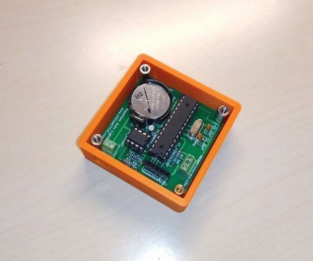

Step 2: The Circuit - Electronic and PCB Schematic
Find the electronic and pcb schematic at link below:
https://easyeda.com/mi.vasilakis/RFID-RS485-ARDUIN...
You can make any changes you want!
We used the JLCPCB for $2 PCB Fabrication & 2-day Build Time, the quality is really good, check the below photo of our pcb board. JLCPCB it will not charge you for any color selection for your pcb board! Enter here to produce your PCB board!
