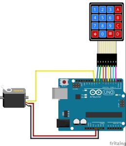

Step 1: Step 1: Wiring for the Servo
Keypad Wiring
1st wire goes into 2
2nd wire goes into 3
3rd wire goes into 4
4th wire goes into 5
5th wire goes into 6
6th wire goes into 7
7th wire goes into 8
8th wire goes into 9
Servo Motor
The power wire goes into 5v
The ground wire goes into ground
The active wire goes into 10
