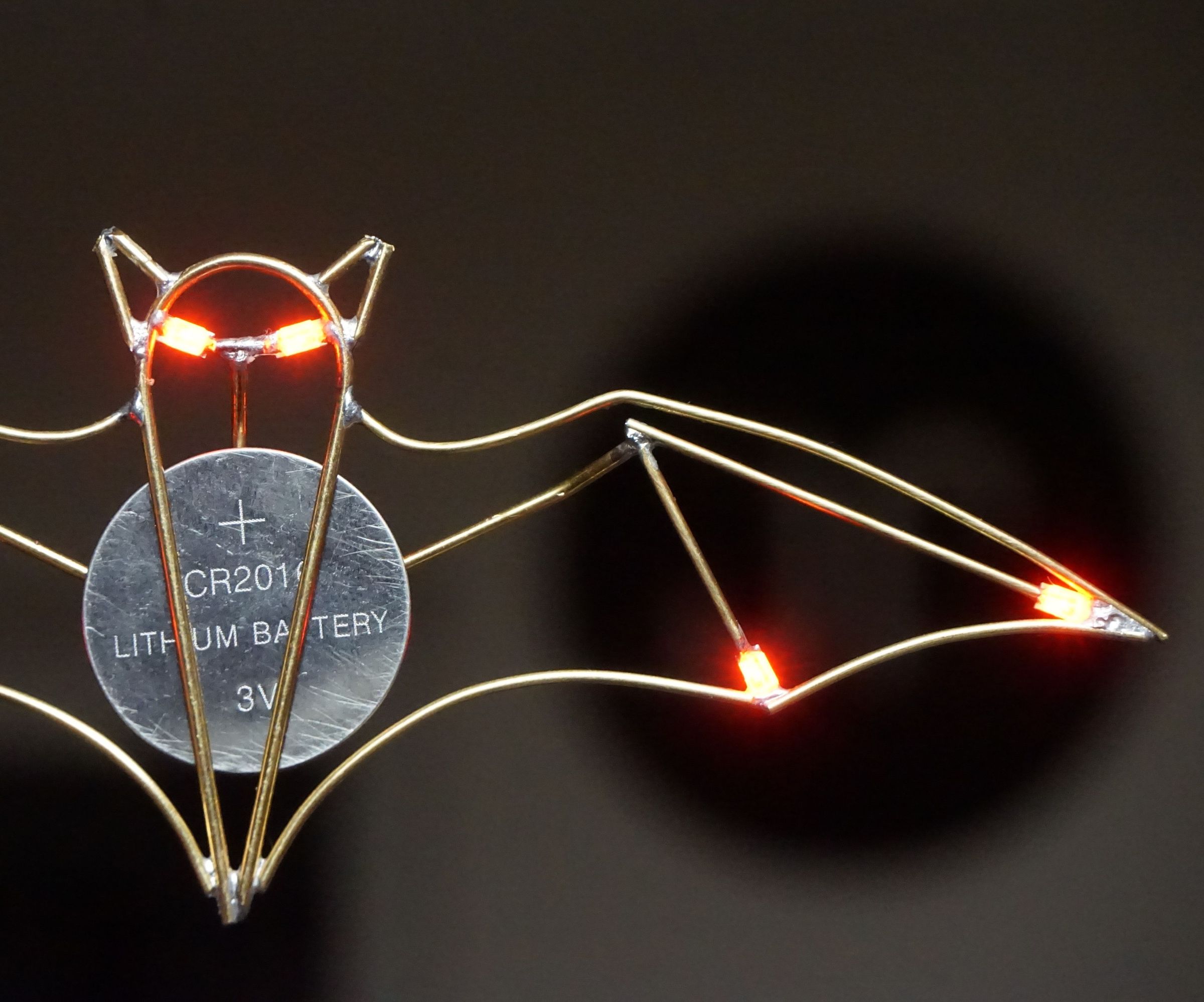

Check out my simple brass LED jewelry for the basics of brass soldering, required tools, and materials.
