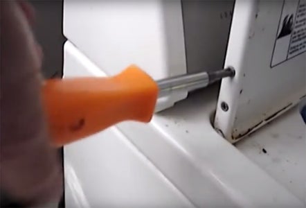

Step 1: Remove Your Existing Lid
This is pretty simple. Just remove with appropriate tool (screwdriver, hex, torx key, etc.)
SAVE the original lid, screws and parts here. You may want to reinstall the original some day.

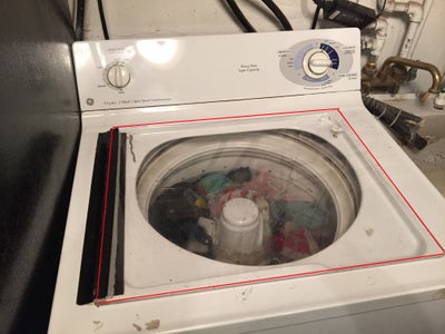

Step 2: Cut Your Plexiglass
Cut your acrylic to the size you need. Use your original lid as a template. You'll need a jig saw or scroll saw here.

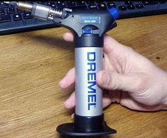

I've found using a small torch (like this Dremel Tool VersaFlame™ Multi-function Butane Torch that I won from an Instructables contest - Thank you Instructables!) to clean and polish the edge of cut acrylic makes it much more pleasing to look at. Not necessary but if you have a way to do this, give it a try.

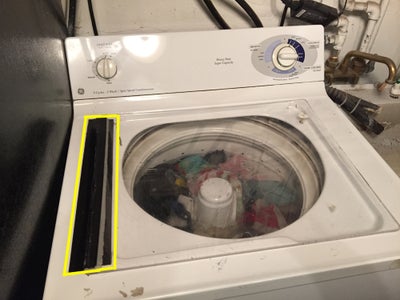

Step 3: Make a New Hinge
Easiest way to make a hing is to use Gorilla Tape®. Put a layer of tape on both sides as pictured. Best part here, this is it's not permanent and you don't need to drill any holes to attach a hinge to your washing machine.
Make sure you clean the washing machine well before you attach the tape. Remove all any soap residue or dirt before you do this.
