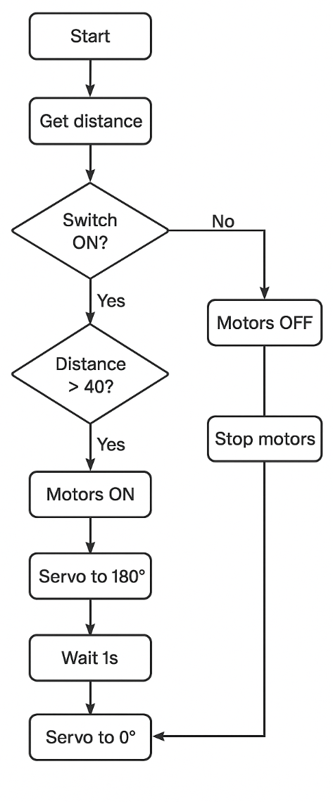

Step 1: TinkerCAD
When creating the Arduino board in TinkerCad, reference the picture, flowchart, and code file. The code has detailed comments explaining what it does.

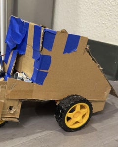

First, attach the sides to the robot with tape. You can add the 2 in x 2 in piece and 5 in x 2 in pieces to above and to the sides of the ultrasonic sensor. We initially left a space so that we could adjust wires or switch if needed as seen in picture 1.
Then, tape the top of the robot. You can staple the 3 in x 1 in strip with the 10 in x 6 in piece to create a flap as seen in picture 2. This way, the switch in the robot can be turned on and off by simply lifting the flap. Now, use tape to cover any extra area to cover all wires.

The gear motor will be placed vertically in the cardboard as seen sticking up in the first photo.
To be able to attach the wheels, you will need to drill holes in the side of the cardboard as seen in the second photo. Secure with tape.
Then add both of the wheels to the white pegs on the gear motor.

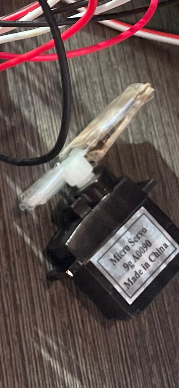

Step 11: Attach Servo Motor and Any Extra Cardboard to Robot
First, cut out a small piece of cardboard that will cover the water bottle. Tape a small piece of cardboard onto the servo motor like seen above. This piece will keep the seeds from falling out constantly. Then, attach the servo to the bottom of the board with velcro.
