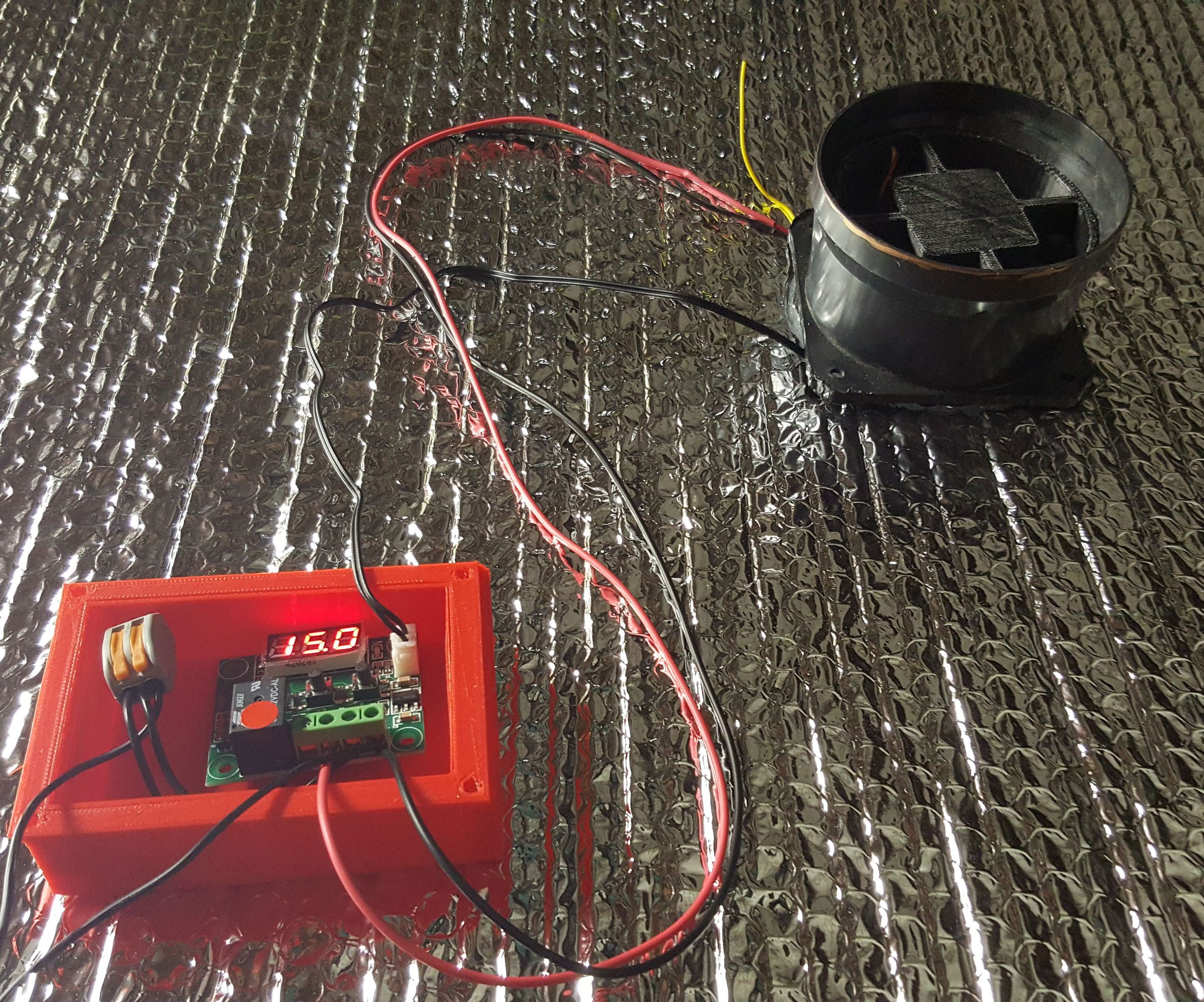

I put some velcro tabs on the one end so that I can open it up and check things out easily. With the lights on the inside the temp gets up to 24-25 C which is about perfect for germinating and growing seeds. This way no light is wasted and the soil won't dry out as fast because of the enclosure.
I plan on adding a temp switch to turn on a small computer fan that will vent the inside if it gets to hot so that I don't fry my plants. But right now its staying right about a perfect balance without the fan. As winter ends and the basement warms up that may be a different story though. You can get cheap temp switches on amazon or you could build your own IoT sensor that you could track while you are away as well.
