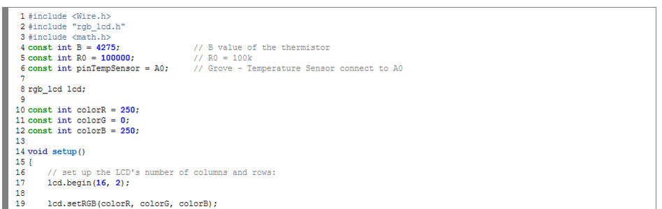

Step 6: 5th Tutorial: LCD RGB Backlight With Temp Sensor
This Grove enables you to set the color to whatever you like via the simple and concise Grove interface. It takes I2C as communication method with your microcontroller. So number of pins required for data exchange and backlight control shrinks from ~10 to 2, relieving IOs for other challenging tasks. Besides, Grove - LCD RGB Backlight supports user-defined characters. Want to get a love heart or some other foreign characters? Just take advantage of this feature and design it! This product is a replacement of Grove - Serial LCD. If you are looking for primitive 16x2 LCD modules, we have green yellow backlight version and blue backlight version on sale also.
Features
- RGB Backlight
- I2C communication
- Built-in English fonts
- 16x2 LCD
Tutorial updates can be found here: https://www.ardumotive.com/lcd-rgb-backlight-with...
Grove - Temperature Sensor uses a thermistor to measure ambient temperature. The resistance of thermistor changes based on ambient temperature. This resistance value alters the output of a voltage divider which is measured by an analog input pin and converted to a temperature value. The operating range is -40 to 125°C , with an accuracy of 1.5°C .
For this tutorial we will need:
- Arduino UNO
- Grove Base Shield
- LCD RGB Backlight
- Temperature Sensor (Connect Grove-Temp sensor to A0 port of Grove-Base Shield)
