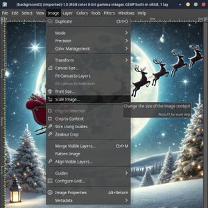

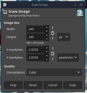

Our Round Display for XIAO has a 240x240 resolution. We need to resize the images. I'm going to show how to do it using GIMP

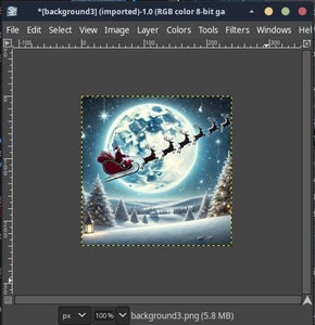

  1. Open the image
  2. Go to Image > Scale Image
  3. Set Width and Height to 240. Because the Keep Ratio is selected (the chain), once you change the width, the height should also change.
  4. Press the Scale button.

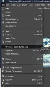

  5. Save the image (I'm going to override the old one)

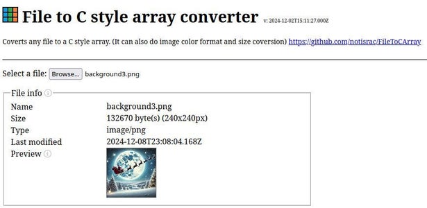

To create the flash array, go to File to C style array converter
The steps are:
  1. Upload the image using Browse .

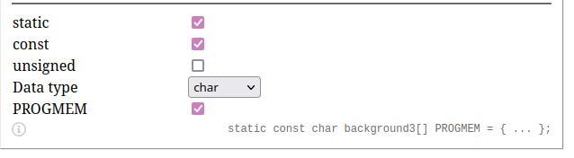

  2. After uploading the image, we need to set some options
  3. Treat as binary
  4. All the other options gray out.
  5. Let's change the Data type to char

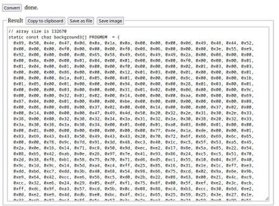

  6. Press convert. This will convert the image to an array.

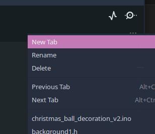

  7. You can now press the button Save as file to save your image and add it to your Arduino Sketch or press the button Copy to clipboard If you Copy to clipboard, you'll have to press the 3 dots on the right side of the Arduino editor and choose New Tab
  8. Give it a name (generally your image name with .h extension)
  9. You'll end up with all your images as .h files.
