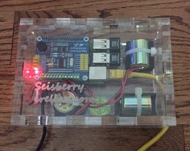

- Set the jumpers on your AD board as in the picture (top right, yellow jumpers).
- Connect the board to the GPIO of the Raspberry, and put the 2 screws and spacers coming with the board.
- Solder the wires to the geophones. I use about 6 inches of wire. Geophones are polarized, so the red goes on the + and the black on the -.
- Connect the geophones to the board, as in the picture (G1 is the vertical component).
