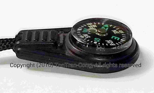

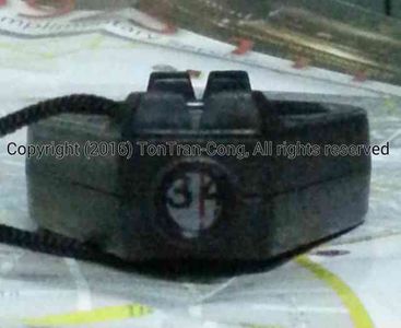

Figure 1:(Left to right) Tiny liquid filled disc compass, simple compasses with and without needle lock. Figure 2: A hazardous Chinese imitation of the German Kasper & Richter Meridian sighting compass, the imitation has its graduation markings self-detached after only washing by clean water from a tap! The black markings on the white rotating dial under the top circular glass can be seen lying randomly after peeling off.
A serious compass should be able to withstand falls of 2m into boxes of sands, to withstand hot and cold environmental temperatures, to withstand immersion in water, to withstand strong sunlight.
The liquid inside a liquid filled compass reduces stresses on the pivot caused by linear acceleration on the mass of the compass needle assembly; this makes the compass more robust. Serious dry compasses should have needle locks to remove acceleration stresses on pivots.
Liquid filled compasses should have pivots with spherical heads. These spherical heads need to be covered by lubrication fluid in operation but last longer than those with pointed conical head.
The Chinese, tiny (originally liquid filled) compass of Figure 1 has completely dried up after about one year of usage. However, it can still correctly point North when given gentle vertical vibration during use.

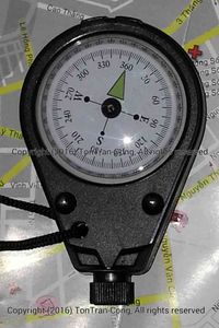

Figure 1,2,3: A simple, plastic compass based on the Suunto compasses for touring. Please note that this imitation compass may be neither as durable nor as reliable as the genuine one.
A well made, simple compass rarely has malfunction and the first sign of any malfunction is obvious to see.
Liquid filled compasses will show bubbles when any liquid is lost and the malfunction and loss of robustness are gradual.

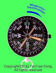

Obtain the magnetic deviation for your area. This deviation is commonly between (-45) degrees and +45 degrees and it slowly changes to a new value every year. The deviation is obtainable from the internet or by the method given in reference [2]. Positive magnetic declination means the Magnetic North is on the East of True North.
If you have a really erasable marker for your top glass/plastic dial, you can use it to mark the magnetic deviation from the long marking line for True North on your compass dial. The marking has to be erased and redone when the deviation has changed significantly. If you don't want to mark on the dial, you can stick a tape on the underside of the compass and write clearly on it something like "MD = (-1)deg" (This is only an example value, your value is different).
Every time you use the compass, you only need to align the needle/rose to your marking on the dial and the long line for True North on your compass is already aligned.

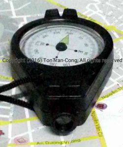

If you do sighting using a compass with a rotating compass rose which always points to magnetic North, just read the graduation on the card and ADD the signed magnetic declination to it.

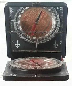

Figure 1: Plan view of a plastic mirror compass. The mirror is opened by 110 degrees from its close position. Figure 2: End (operational) view of the same mirror compass. The mirror is opened by 45 degrees from its close position. The clear capsule should be rotated by the thumb until the fluorescent double II marking on it is on top of the North end of the needle. Figure 3: Hand posture for holding type M-1950 compass for sighting with a stretched arm. The finger through the brass ring is the middle finger. The sighting is carried out using the slit in the sighting tab and the wire in the lid. The lens has no function in this sighting mode. This is my own novel mode of operation not designed by the makers of type M-1950 compasses.
Using the Mirror Sighting compasses.
The Mirror Sighting compasses are for a special mode of operation with reduced influence from user's magnetic field. This feature allows the compass to be used with stretched arms keeping it away from the user's body. A mirror compass is used in the following way:
Hold the mirror compass at your eye level, horizontally level on one stretched arm, away from your head, with the mirror tilted from the vertical by 45 degrees to let your eyes see the reflection of the working horizontal needle and dial of the compass. Take aim of the destination by the aiming guide and observe the horizontal magnetic needle through the mirror. Rotate the rotating dial on top of the needle to mark the position of the needle. For accuracy, keep the vertical marking line on the mirror superimposed on the aiming diameter of the horizontal dial of the compass. Finally bring the compass to your comfortable reading distance to read the marked position of the needle. The magnetic bearing of the aiming line is the value on the scale at the point nearest to the mirror.
This is a desirable feature if the user carries magnetic items and it is not practical for him to take off these items when using the compass. The sighting mirror can also be used as a signaling mirror and personal mirror. This feature was favoured in the 1940's.
The compass in figure 2 has only a very crude aiming guide. It follows the design of Silva Trekker compasses.

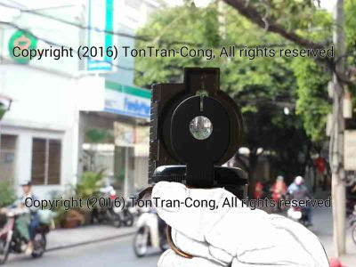

Using the lockable compasses.
Any tilt tolerant, lockable compass can also be used in this mode (with reduced accuracy) even without any mirror. Tilt tolerance ensures that the needle can point North before the lock is engaged to freeze it in place. The ex_US Army compass (model M-1950) in figure 1 of Step 2 can be used in this mode, and is surprisingly accurate, as it is tilt tolerant and the inertia of its rotating compass rose ensures that the needle orientation is retained while the lock is engaging. A lockable M-1950 compass is used in the following way (This is my own novel mode of operation, not designed by the makers of type M-1950 compasses. Do NOT complain to them that their compasses are not comfortable to use in this way!) :
Place the lid and the sighting tab of the M-1950 compass in vertical positions to have the compass in unlocked and operating condition. Turn the holding ring near the sighting tab fully downward. Curl the middle finger of your hand and stick it through the holding ring of the compass. Grip the compass by pressing the end of the index finger against the lid hinge and the joint of the thumb against the sighting hinge. Stretch your arm while holding the lensatic compass horizontally level at the height of our eyes, away from your head, with its lid vertical and its lock still fully disengaged (sighting tab in vertical position).
Take aim of the destination by the aiming guide then hold till for 3 seconds. Gently engage the lock (push the sighting tab into horizontal position) by only raising only the first joint of your thumb to push against the bend of the sighting tab while keeping the rest of the body motionless. After having been locked, the whole compass is bought to your comfortable reading distance to read the locked position of the needle. The magnetic bearing of the aiming line is the value on the compass rose at the point nearest to the hinge. It is hard to read but is definitely readable even with the sighting tab fully down.

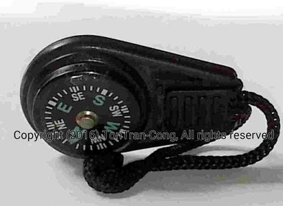

Step 11: ​Special Operating Mode 2: Using Small, Fluid Deficient Compasses.
Figures 1, 2: A two years old Chinese key-ring compass (with diameter of about 20mm) has visible air bubbles. Some bubbles or all bubbles may stick under the compass disc, under the S in figure 1 and under the SW in figure 2. Figure 3: The compass is tilted by 100 degrees to have all bubbles collected at the upper side of the compass disc. Figure 4: All gas/air is now above the compass disc.
A fluid deficient liquid filled compass should be repaired and refilled with the same type of fluid to restore its original, designed performance. However, a small such compass can still be used in reduced performance mode (for emergency) employing the following work around.
The capsule of of the liquid filled compass should be held upright. It is then tilted 100 degrees from its upright position to let any bubbles from underneath its compass rose (rotating disk) escape to the space at the top of the (now vertical) rim of the rose. The capsule is then tilted back to its upright position, ensuring that all air stays above the rotating rose. With all air expelled to the top of the compass rose, the latter can rotate although with reduction in accuracy because of undue tilting torque exerted by air bubbles.
Gentle tapping and vibration in the direction of the pivot axis will free the rose in multiple short time intervals while it travels/bounces between extreme positions. This is sufficient to make the magnetic needle of the rose point close to magnetic North.
Any small, completely dried, liquid filled compass may be made pointing North by such gentle vibration/rattling.
