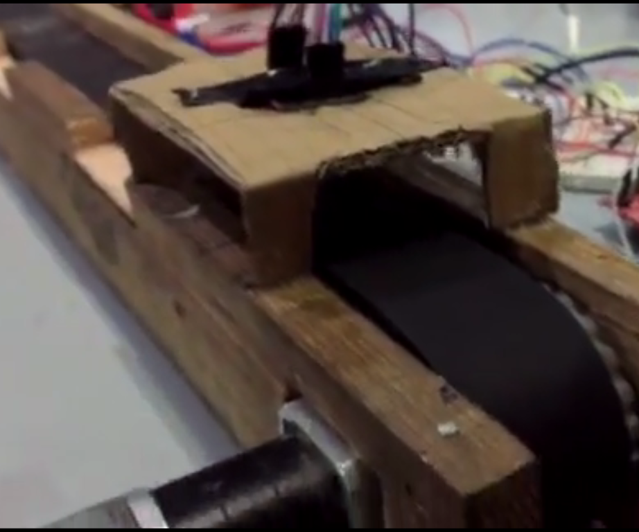

During the experimentation, the speed of the motor was successfully controlled using the PID Algorithm. The curve however is not exactly a smooth straight line. There are many reasons for that:
• The sensor though connected to a low pass filter still provides certain finite debouncings; these are due to the non linear resistances and some inevitable reasons of the analog electronics.
• The motor does not rotate smoothly under small voltage or PWM. It provides jerks that might cause some wrong values fed to the system.
• Due to wobbling, the sensor might miss some slits providing higher values. • Another major reason for errors can be the core clock frequency of the STM micrcontroller. This model of STM microcontroller provides a core clock of 168MHz. Though dealt with this problem in this project, there is an overall notion about this model that it does not exactly provide such high frequency.
The open loop speed provides a very smooth line with only a few unexpected values. The PID Algorithm is also working fine providing a very low settling time of the motor. The motor’s PID Algorithm was tested under various voltages keeping the reference speed constant. The voltage change does not change the speed of the motor showing that the PID Algorithm is working fine
