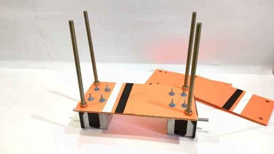

Step 1: Structure
For a balancing robot the most important thing is the frame. The performance of the balancing robot is totally dependent on the structure of the frame. Try to make the frame small and as light as possible. A light weighted frame will help to get an optimal performance. The basic approach is to make a three layer frame, where the motors are connected at the bottom layer and the remaining circuit will be fixed in the middle layer. However you can also customize the design according to the project requirement. Read More >>

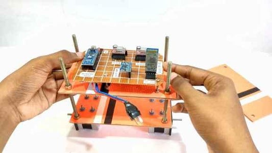

Step 2: Circuit Connection
Now you have to make the circuit. You can make the circuit at your home by using vero board or you can directly order a PCB from any PCB manufacturing company. While designing the circuit, you have to keep some important fact in your mind. Try to put the gyroscope sensor mpu 6050 at the middle of the circuit. Also place the a4988 motor driver at any side of the circuit. It is recommended to use Arduino Nano in spite of using Arduino Uno. This will make the circuit simple and less bulky. Now take a look at the connection below Read More >>

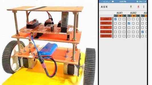

Step 4: EZ Gui App Setup
Now you have to download the EZ Gui application from the Google play store. Open the application and connect it with the balancing robot via Bluetooth. Once connected, go to the AUX settings and then configure the robot. Then set the PID values according to your robot. The PID values may differ in each and every robot. The PID values depend on the robot size and construction. A sample value of PID is given here Read More >>
