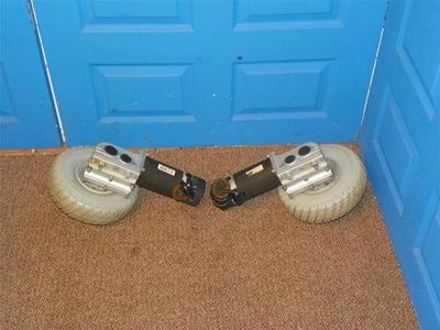

Hey frm where can i get these wheels https://cdn.instructables.com/FSC/A828/HF23MYGN/FSCA828HF23MYGN.MEDIUM.jpg
Reply 7 years ago
I got those on ebay. Jazzy electric wheel chair motors
Reply 7 years ago
Wheels in the image
