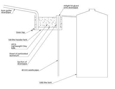

1500 litre barrel with a lid (it's a barrel that was previously used for importing concentrated orange juice)
100 litre header tank (usually available free or very cheap as people remove them when modernising their houses)
A 3m length of 40mm diameter pipe for the overflow
Perforated aluminium. The piece illustrated here was some scrap lying around an industrial estate. It's commonly used as cladding on industrial buildings.
A short length of downpipe to make the syphon tube. I used square stuff, as I had that available. Round is also fine.
The top of the syphon tube is closed off with an aluminium of plastic plate. It needs to be sealed airtight for the syphon to work, so some sealant such as Sikaflex will do to glue the lid on.
Some lengths of downpipe and connectors to transport the water from the house downpipe to the water filter. The bottom of the last piece of downpipe is cut as shown, so that the pipe can rest on the bottom of the tank, but water can pass through easily.
The only filter medium I've used is LECA - Lightweight Expanded Clay aggregate. It's ideal. I had some left over from another job. Coarse sand should work OK as well.

Take a close look at the design and notice the heights of the top of the filter tank, the height of the drain pipe, the height of the syphon tube and the level of water in the storage tank when it's full. I've drawn it carefully!

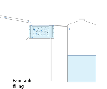

Here's the flow of water when the storage tank is filling, how it will be most of the time.
Rain water flows through the downpipe and enters the filter tank at the bottom, under the perforated aluminium sheet. It then flow up through the holes in the sheet and through the filter medium. The water then flows out the outlet pipe into the storage tank.

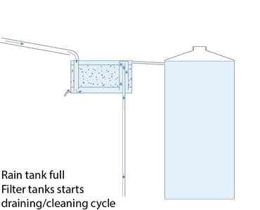

Step 3: Step 2 - the Full Tank
So the storage tank gets filled until the water level reaches the level of the water in the filter tank. Then the levels in both tanks rise a little more until...
Step 4: Step 3 Flushing and Cleaning the Filter
When the water level reaches the top of the waste pipe inside the syphon pipe, it starts pouring down the long waste pipe. The water has a long way to fall, and accelerates, creating a bit of a vacuum behind it - enough to draw down any remaining air at the top of the syphon tube. Then the syphon really starts to flow, like when you flush a toilet. The water is sucked out of the filtrate, dragging with it any debris trapped there and it all shoots down the waste pipe. When the filter tank is empty, air enters the syphon pipe and the drainage stops. While it continues raining, the filter tank is again filled to capacity, and then again, flushed back in the opposite direction until it's empty. It cycles like this for as long as it rains and as long as the storage tank remains full.

So to help with that, as I stated above, pay attention to the levels. The top of the waste pipe needs to be about 25mm or and inch below the top of the syphon pipe lid.
Another thing to watch for is getting the pipe diameters right. I calculated the cross section area of the syphon pipe minus the area of the down pipe to be equal to the cross section area of the down pipe. This mean that there were no pinch points in the flow of water - it always had the same area of pipe to pass through.
The bottom of the syphon pipe has cut out sections on each side up to the level of the aluminium sheet to allow the water to flow through easily. You can't see that in any of the photos, but if anyone needs any further illustrations or clarifications, let me know!
