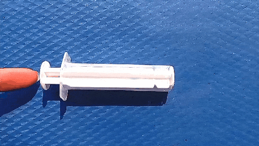

• Take another 20ml syringe and cut off the tip so that the piston can pass outside it on pushing the piston through the tube.
• Using a marker or pen, place the syringe tube on the cap and trace out the size of the syringe tube on the cap.
• Using a pen (due to it narrow pointed cutting blade), cut out the drawn circle.
• Place the syringe tube through the hole into the bottle cap making it pass through it for about 3cm.
• Apply generous amount of hot glue around the side of the syringe tube and plastic cap to hold it in place and avoid leaks.
• Insert the piston into the syringe back in case it's been previously removed.
• Screw the made tap back onto the keg.

• The mechanism is simple, when you push the piston of the syringe up, it allows a passage for the water out which in turn sucks air in as bubbles.
• Once you remove the pressure pushing it up, the weight of the water pushes the piston back into the syringe and closes the tap.
