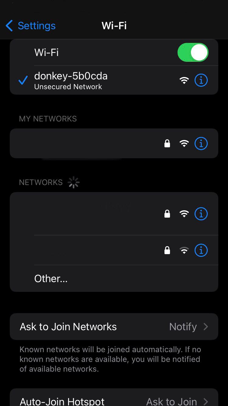

Turn on your Raspberry Pi and wait for the green light to stop blinking (may take up to 3 minutes). Next, go to the WiFi settings of your phone. You should see a network similar to "donkey-xxxxx" show up. I included a screenshot of what it looked like on my phone. Please keep in mind that the last 5 digits for you might not necessarily be the same.
First Time Set Up
  • Launch the app and agree to all the terms and conditions
  • You will see your car appear with the IP address 192.186.50.1
  • Click on your car and you will be taken to the setup screen
  • choose the correct controller type (PCA9685), country, and enter your WiFi network's credentials
  • Review your settings
  • By this point, your phone is probably disconnected from the Pi's Hotspot as it is now connected with the WiFi you just entered the credentials for
