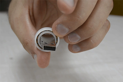

In this Instructable I created a self-flipping pen drive.
As long as the USB port is vertical, you pen drive will flip correctly every single time.

Step 1:
Find a pen drive that's the same size as the USB plug.
You can go with a bigger pen drive, but then you might need to get a bigger bearing.
Get a nylon bearing and a fishing sinker.
Step 2:
Cut/shave your sinker, so you can fit it (together with the pen drive) inside of the bearing.
Push the sinker and the flash drive inside of the bearing
Warning!
After some people suggestions, it's better to use different material weight.
Lead weight can be poisonous if you eat it or breath IN lead dust.. Even though it does not get in contact with food and we don't create any dust, it's better to use a different material weight
Step 3:
Glue it all together.
Next time you try to plug in the pen drive in the dark, hold it by the bearing.
It will flip the correct way.
